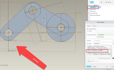

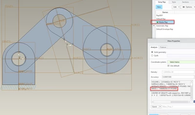

The only way I would know to do this would be to create a simplified rep of the parts you wish to get mass properties from.
