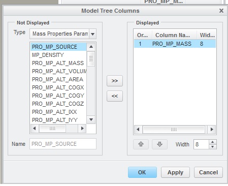

In my assembly I had a three components .
ex:
assembly used mmns template , material not assigned
first part used mmns template
second part inch ibm template
third part used mmks template
obviously all the baove three parts had different template.
After I assemble all the above components & check the mass properties it is showing in tonne and mm3 . How it is calculating ?Is main assembly calculating all the part template units ?
April 7, 2014
I guess so. It think its just calculating the individual mass in part template unit. In assembly it calculates in assembly units. You can click on tree filter and add one column PRO_MP_MASS. as shown in attache picture1.jpg

Hi Haris,
When calculating mass properties of assembly, calculation will convert the units (internally and no physical change in part units) of parts to get results in assembly units.
For e.g. three parts of 1x1x1 created using:
- mmns template
- ibm template
- mmks template
will result mass as:
- mmns template = 1.0000000e+00 TONNE = 2204.62 Pound
- ibm template = 1.0000000e+00 POUND = 1.0000000e+00 POUND
- mmks template = 1.0000000e+00 KILOGRAM = 2.20462 POUND
But when calculating mass in assembly (created using default template of Creo) result will be the sum of all three masses (in Pounds) will be as 2.2078272e+03 POUND.
I think when calculating the mass properties the results in tonne and mm3 (which you are referring) are for Average Density.
