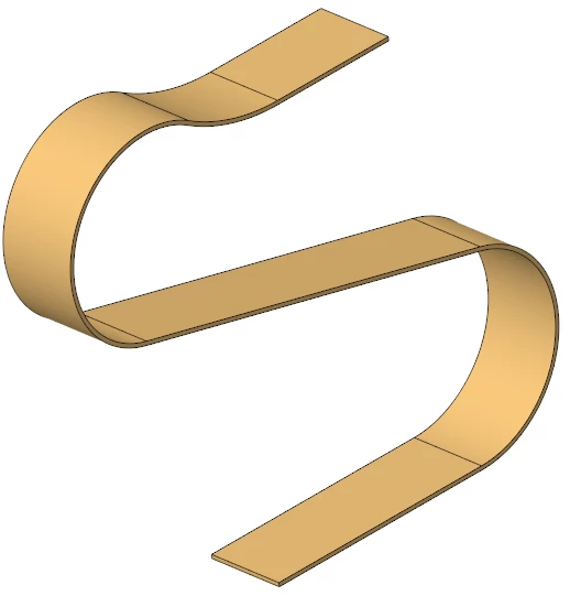

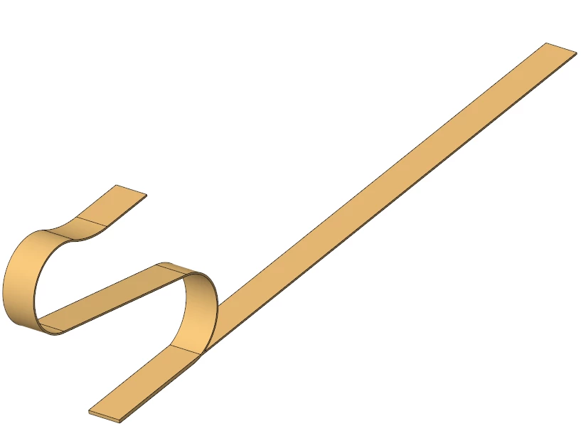

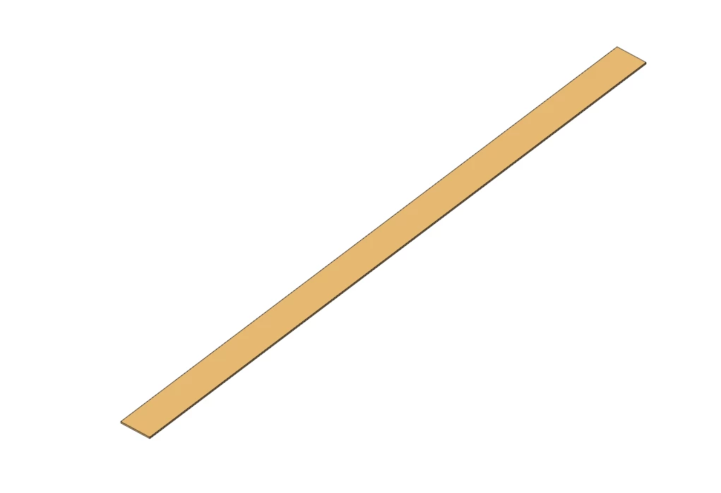

Attached you will have a very simplified example of the modeling I'm doing at this moment.
I am modeling an FPCBA using vanilla Creo 5.0.*.  In this situation, I would like to have a configuration that pertains to the in-assembly geometry (Figure_A), and I would like to have a configuration that pertains to a 2D Drawing geometry (Figure_B).
Currently, the default Master Rep defaults to Figure_C, which overlaps both configurations. Although the appearance of the model in Master Rep is undesirable, I can live with this. The problem is that the Master Rep creates overlap of geometry features which then have cascading errors for whichever design I did second. This leads to error messages when saving, and obfuscates which errors are "true" and which errors are due to the overlap. I can't seem to edit this Master Rep to only reflect the geometry of Figure_A.
Is there any method to avoid the series of errors associated with the overlapping geometry? Or better yet, is it possible to change the Default Representation to represent only one configuration so as to avoid the errors?

An option to try is to use Flexibility.
  • Create the flat version
  • Suppress the flat version (to prevent references to it)
  • Create the as assembled version
  • Suppress the assembled version
  • Resume the flat version
  • Assemble into the assembly
  • Apply flexibility to the part
    • In the varied items dialog, select the features tab and add features of both versions
    • Change the status of the features as needed
If several features are required for each version, group each set of features and suppress and resume the groups.
Can give more detail if needed.  Predefining flexibility in the part could also help if it is used in more than one assembly.

Ok, I think I understand your issue better now. It is indeed an annoying problems. As you point out, you can't suppress features in the master rep and activate them in a simp rep. And applying geometry on top of geometry can cause issues.
How about a feature after the first configuration that cuts away all geometry? I'd do it with a datum plane and Solidify, or even more stable, make an all solid surfaces selection, copy and Solidify. That would never have a problem with lost references or dimensions that need updating.
This way, the master rep would look like the second configuration you model, and a simp rep could suppress the Solidify feature and everything after it, revealing the first configuration.
