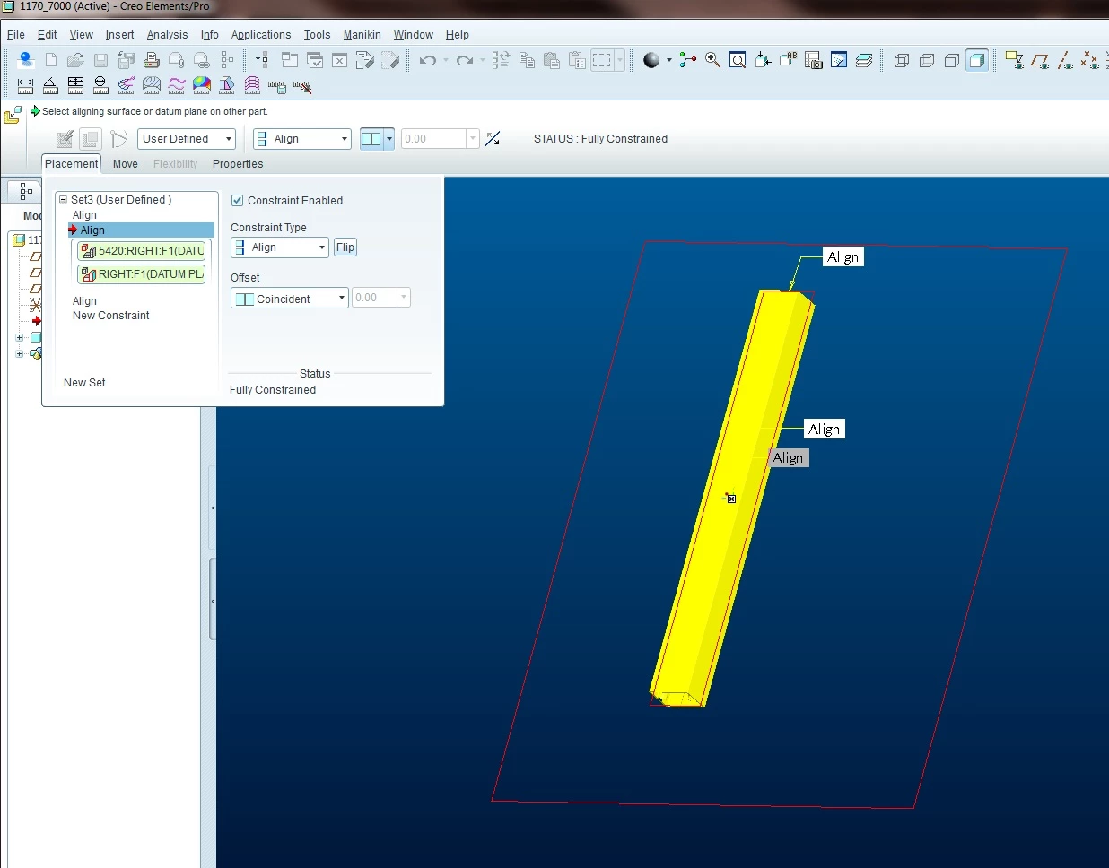

I have an assembly that has an orientation (i.e. right and left hand assembly). The parts do not have an orientation (no handed - it just depends on how they are assembled).
The part I want to flip orientation is the base part of the assembly (first part).

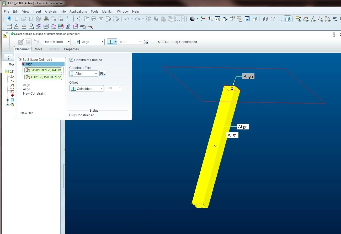

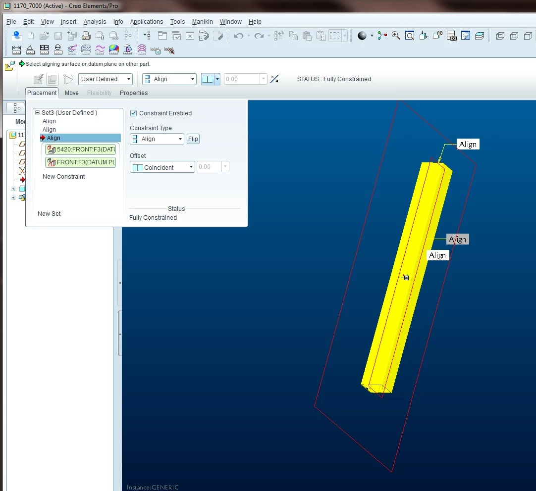

The first assembly (call is right hand) has the intial part assembled to the assembly planes as align, align, and align. If I could change this to mate, mate, and align, I would get my mirror (left hand) part. Is there a way to put the mate/align parameters in a family table?
Dale
