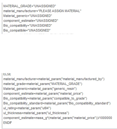

I am having trouble finding the material ID for use in a note.  I have created a new parameter in my material called "SPEC" that I'd like to use in my note.  But I cannot find where to get the MTRL_ID

Hi, Here is the way I do it.
If your user defined parameter in material is called SPEC then to reuse that as a note the I pull the material parameter into a model parameter. It might work by just doing &material_param("SPEC") but I would create the relation to make SPECIFICATION=material_param("SPEC") then the note is &SPECIFICATION. As it happens I also have IF else statements to show the note as unassigned if the material has not been assigned to the part.

Segment from my Relations:
/*** SET MATERIAL PROPERTIES ***
IF PTC_MATERIAL_NAME=="UNASSIGNED"
MATERIAL="UNASSIGNED"
MATERIAL_DESC1="NO MATERIAL ASSIGNED"
MATERIAL_DESC2=""
MATERIAL_DESC3=""
ELSE
MATERIAL=material_param("PDM_NAME")
MATERIAL_DESC1=material_param("DESCRIPTION1_U")
MATERIAL_DESC2=material_param("DESCRIPTION2_U")
MATERIAL_DESC3=material_param("DESCRIPTION3_U")
ENDIF
Once a material is set, the relations pull the parameter information in.
