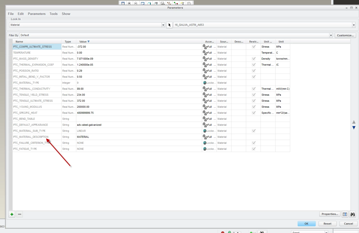

Material Parameters within a note
Is it possible to reference the PTC_MATERIAL_DESCRIPTION within a note.... this parameter is located within the assigned material. It works if i grab it within a table on the drawing, BUT is it possible to do it within a note... if it is, what is the procedure to do so.
If someone could please help me with this that would be great, this would benifit, right now we are creating a parameter called &material.... but it is not related to the designated material, so when someone changes the material of the part, the material note doesnt updated, it renames the same.

I was just searching PTC KB for a keyword and found a much better solution.
Set the Relation in your model to
MATERIAL=material_param("PTC_MATERIAL_DESCRIPTION")
and that will assign the description to the currently active material.
It is absolutely amazing that this was not pointed out earlier in my many tech support calls to PTC.
You can find the detailed solution at:
https://www.ptc.com/appserver/cs/view/solution.jsp?n=CS44055

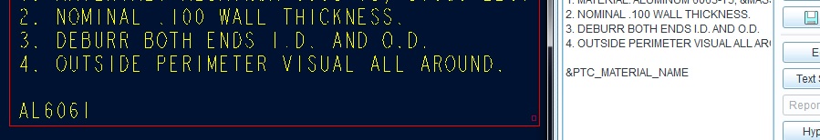

Have you tried &ptc_material_description in the note? That works with other parameters. You'll need to have a space before and after unless you use the { } brackets.

That does not work... it works within a table when i do a report parameter though! But I want it on a note.

Maybe I am looking at the wrong thing, but here it is in a note for me.
The left shows AL6061, the text box on the right shows &ptc_material_name.
