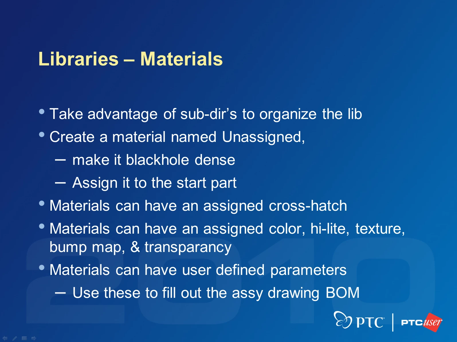

This slide is from my ProE Admin 101 talk back in 2010. There are a lot of things you can assign to a material. This was based on what was available in Wildfire 2.0.
The reason I suggest having an unassigned material and making it black hole dense is so it will be readily apparent that something is wrong with your weight when you run a mass property calc. Then by showing the model tree columns for mass, & density. You can easily find the offending part in a large assembly.
[cid:image001.png@01CF4734.A14B1E80]
