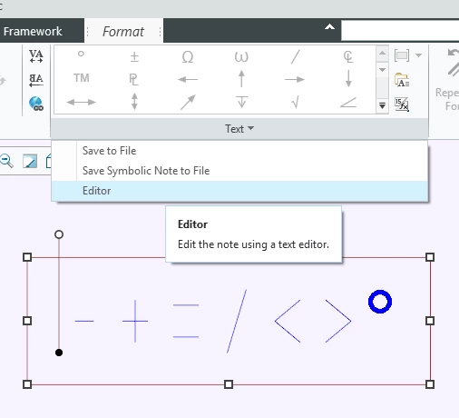

kdirth
Sep 23, 2026 4:14 PM UTC
You can also use the editor to get a few more options.
