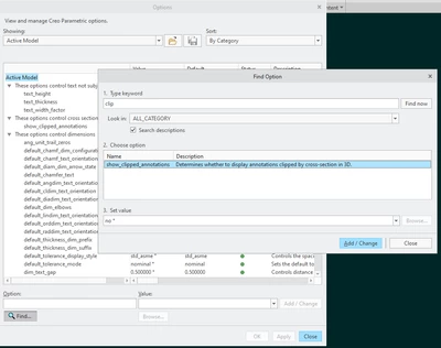

Oct 11, 2023 8:46 AM UTC
Try setting the detailing option "show_clipped_annotations" to yes.
Pius14-AlexandriteAuthor
Oct 11, 2023 9:08 AM UTC
Perfect !
Works at the first attempt.
Thank's a lot!

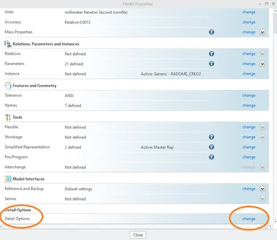

Mfridman
Oct 11, 2023 9:22 AM UTC
Hi @Pius
Have you tried using the following model detail option: show_clipped_annotations yes ?
Oct 11, 2023 9:36 AM UTC
Yes, I did change the definition of properties, and it works !
