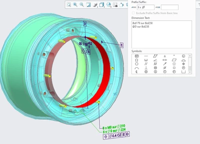

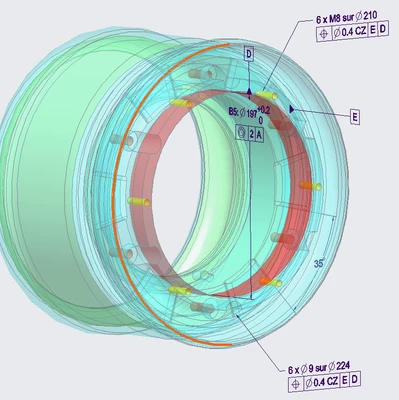

We have a particular case.
We have 2 hole pattern on different diameters with the same Common Zone.
- 1st pattern is 6xM6 on Ø210
- 2nd pattern is 6xØ9 on Ø224
Currently, the dimensions are defined as follows:
We have manually defined the dims as follow:
For the second arrow, we add a leader note at the height of the 6xM8 on Ø210 text note
Could we make it more properly without "manual tinkering" in MBD?
