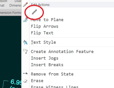

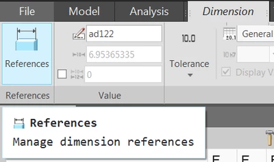

In Creo4, after selecting a dimension, the "References" tool in the ribbon's "Dimension" tab is available to redefine the attachment points:
Alternately, I can right-click on the dimension and select the "edit references" icon:
