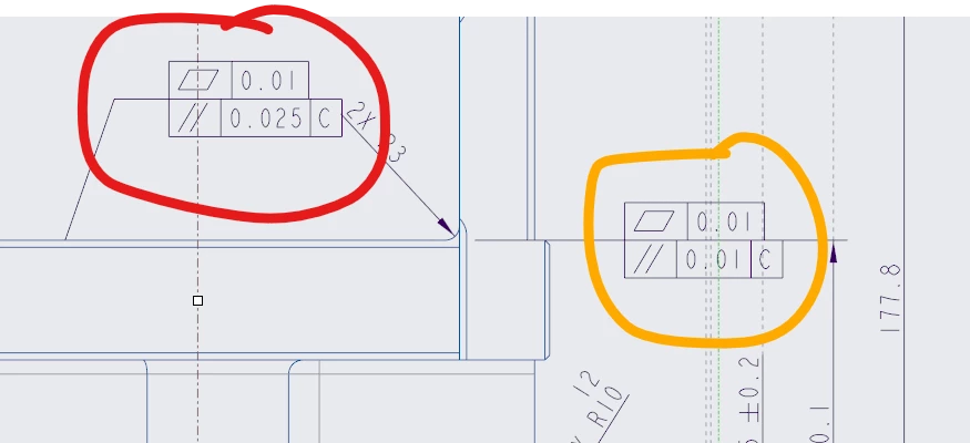

I have some GD&T that was placed in the model(flatness and parallel).  I can show it on the drawing but there's no way for me to make it tanget to a surface.  I can create the GDT in the drawing(draft) and place it tangent.
So whats the deal here?  Am i missing something?
See image below.  The one circled in RED is the one that i did in the model.  The one circled in ORANGE is placed via the drawing.

Hey Jchance,
There might be a better way, but I came up with two workarounds.
1. Create a snap line with 0 offset, click on the GDT, select 'toggle leader type' (example shown on the right). I think this is the best way so far, as it doesn't remove it's original reference. Could maybe make a mapkey to speed things up.
2. Click on the geotol, select 'Change Reference' (example on the left). Now it can snap tangent to the reference. Depending on where it is placed, it could show the GDT incorrectly, but this method involves less work.
