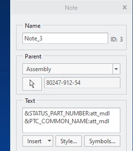

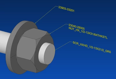

We are starting to venture into MBD (Model Base Definition)
In an assembly we may want to use balloons, but sometimes I may just want to call out the part number.
Using model annotation I found I could use a Leader Note to do this but I don't want to have to type in the syntax all the time.  I thought maybe I could do this with a Symbol... but that doesn't seem to work.
here is what I used for the Note.
&STATUS_PART_NUMBER:att_mdl
&PTC_COMMON_NAME:att_mdl
April 29, 2020
Unfortunate, symbols not work in such way.
Try to write a mapkey. The mapkey must create a note with this text. For example, mapkey can write text to note from a file.
