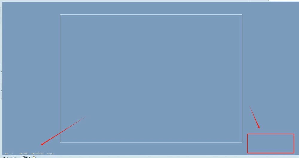

I am trying to hide the labels related to active combined states like Layer state , apperanace state etc.
Also i want to modify or hide some times, the tolerance table label appears in the bottom right corner of the combined state.
But i am not able to find any options to hide or modify these labels. Is it a limitation ? or is there any settings to control it. Please guide me if someone faced this problem.

AFAIK reported functionality is hardcoded. You cannot change it.
Chris3
Jun 25, 2025 12:05 PM UTC
Martin is right. You can't remove it.
https://www.ptc.com/en/support/article/CS110248
From the article - workarounds include changing the text color to be the same as the background color (still overlays on CAD models) or to use the temporary shade option (which is only temporary).
