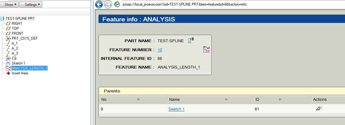

Ok here is how you can do it.
In part mode do measure length. From the pop up window select
Description: C:\Users\rrich\AppData\Local\Temp\SNAGHTMLf5d70dc.PNG
Pull down indicated and choose feature. Click green check next.
You will get a new feature in your tree shown below. If you select info on
this feature you will see like below.
Now in your drawing you can add a note and type in the info for the
parameter LENGTH that is created with the Analysis feature above.
Your note would be this Curve length is &LENGTH:FID_66
Attached are files in WF 4 showing this example. You could rename the
analysis feature to be what ever you wish, and use that name instead of the
feature ID.
To Include a Feature Parameter in a Note
To include a feature parameter in a note, use this format:
&<param_name>:FID_<feat_id>
or
&<param_name>:FID_<feat_name>
