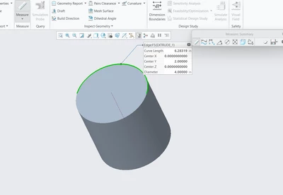

Unless I'm mistaken, I thought you could measure the circumference of a diametrical feature with the Measure Tool?

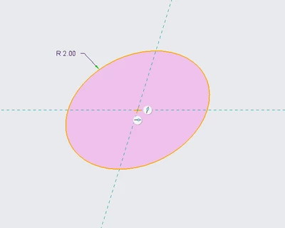

You can. For example I create a sketch of a circle with radius 2 and then extrude it.

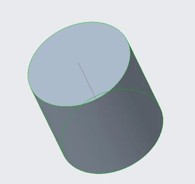

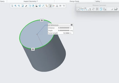

I go to the measure tool and then select the edge of the circular face of the cylinder, this gives me half the circumference.
I hold ctrl and select the other non-selected half edge, this gives me the full circumference.

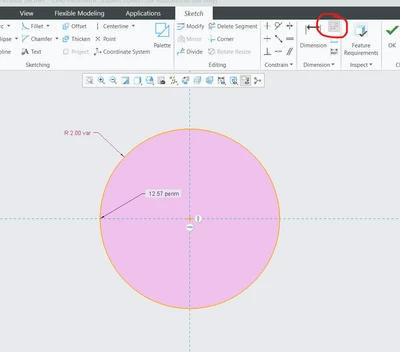

A method that I recently found which might be helpful is defining the perimeter in the sketch itself. I select the perimeter tool, select the circle, click ok in the pop up menu and then select the radius/diameter.

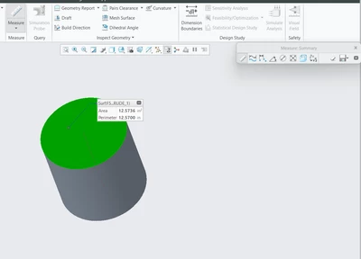

You can also click the face of the cylinder using the measure tool and it will give you the perimeter/circumference. (You may see that the perimeter measurements are a bit different in my previous reply and this one, I had modified the sketch resulting in this difference.)

Thank you, yea that makes sense. Seems when you select the edge itself, it will only select half of the circular edge feature. Never understood why it's like that.
