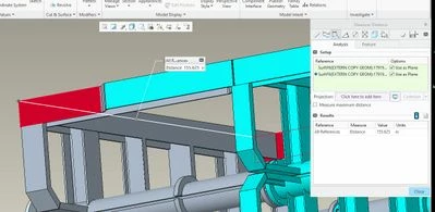

Measure Tool in Creo 2.0
Hi everyone...
I know I've been absent quite a bit. I'm heavy into a very large design task and therefore I'm using Creo 2.0 very, very heavily. While I do prefer it to Wildfire 5... and even to Wildfire 3, there are some parts that drive me insane. I guess I just wanted to get everyone else's impressions as a sanity check.
The Measurement Tool in Creo 2.... how do you feel about it? I spoke to the developers in Anaheim about it and told them I did not like it. I tried to demonstrate some of the issues but I don't think they were "getting it". The implied notion they gave me was that I simply wasn't using the tool correctly. Instead of staying in "Summary", I should be using "Distance", etc. I went back to my job resolved to take another crack at it. Perhaps I was missing just how great the tool was!
Eh... no.
I've making measurements very, very frequently and I do not like the tool. I'll admit my opinion may be colored by fatigue. I've been working 16-18 hours a day (12 on weekends) and I'm putting in tons of time in Creo 2.0. Managers are all over me like bees on honey and I just can't seem to get ahead. But still, is it just me?
To be more uncharacteristically direct ... this tool is a festering POS and I want to do bodily harm to the people who've forced it upon me. The measurement window is always directly under the tool menu. Summary mode is bloated providing me with all sorts of information I don't even want. Distance mode is terrible. I'm clearly picking ON THE SURFACE OF THE MODEL and yet I'm getting edges and vertices 15 levels behind the surface I'm picking. I have to use custom filters, mapkeys, or other techniques to force the tool to do a simple measurement.
I also don't like that I have to hold CTRL to select the second surface. I never had to do that in previous versions because each selection was in a separate reference selector. Now I must use the Query Bin to get the correct surface (because of the problem mentioned about)... but I have to remember to hold down CTRL before I choose it else I lose my first reference. So the measurement process for measuring from plane-to-plane or surface-to-surface is:

Also, I don't like the measurement box floating in space cluttering up my screen. The results window only appears if you open it? I'm taking a measurement, that should tell someone I probably care WHAT THE HECK THE RESULTS ARE. This could be mitigated though if the results were given in the message log like they used to be. But that has been removed. For the love of all that's holy WHY was this removed? Was anyone really complaining that the message log was impeding their work?

‌You may already be using this since this is an old post but select an item in the measure tool, RMB, and select Replace is the option you want when measuring to multiple items one after another.

Just curious what version of Creo you are using?
I just opened creo 4 and did a measurement (measure distance, surface to surface) and it put the distance box in the lower left corner but the surfaces I chose were long and mostly outside of my screen to the lower LH side
I restrarted Creo (to avoid any user contamination, ie I moved the measurement), re-did my measurement, pick 2 surfaces that were within the visible display and the measurement displayed very reasonably this time.
I clicked around using just the generic measure and the location of the measurement window seems completely pick sensitive.
