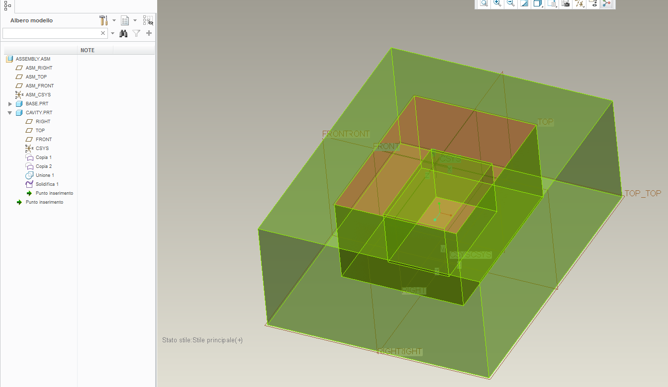

May 8, 2016
For me best way to get associativity without having advancend license for assembly or doing complex famility table, is doing an assembly and copy in a new part correct surfaces and solidify.
