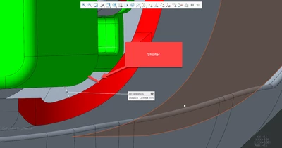

Measurement is incorrectly not showing shortest distance between edge and surface.
I am using Creo Parametric 7.0.4.0
The measure tool is not giving the shortest distance between and edge and surface. Has anyone figured out why this happens?
It seems to use the edge of the surface instead of the surface geometry.

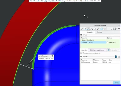

The edge of a surface is part of the surface so if that edge is closest then the measure is working as designed. Even though you are selecting a surface its domain is defined by boundaries. These boundaries would be congruent with edges.   It is hard to tell from your pics what the minimum distance would be.
If you have a license for BMX module you can verify the result.
If you think it is not working correctly then you can place a field point on the surface and create a measure distance analysis feature to be used in an optimization study. Set the objective to minimize the distance and run the study to compare to the measure tool result.

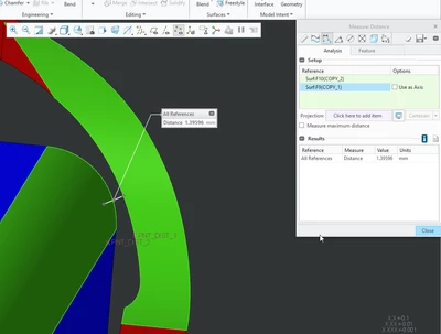

VMcD14-AlexandriteAuthor
Dec 17, 2021 10:45 PM UTC
Hey tbraxton. Thanks for responding.
There a locations on the blue surface that are closer than the edge.
If I measure surface to surface, the closest point of the red surface is the same edge in example #1. But the blue surface location is shown mid surface.
tbraxton
Dec 17, 2021 10:55 PM UTC
I now understand, you see different results when you expect them to match. Nothing comes to mind to explain that. I would need to query a model with those surfaces to investigate. If you post something I will see if I can replicate the results you are seeing.
