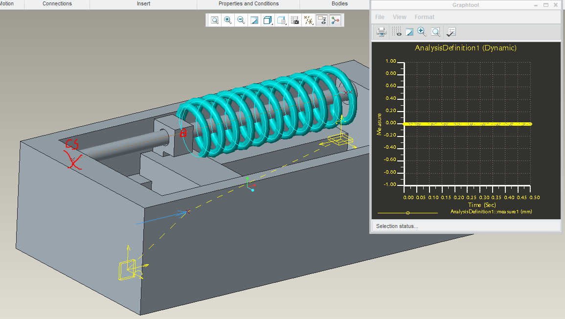

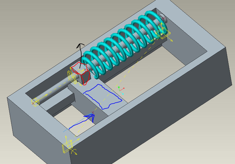

Hi All,
I have a problem, where I want to analyse how slider block can affect the guide bar. I have looked through good few tutorials on YouTube but nothing seems to match.
There is a welded frame where a slide(marked blue)  is moved by hydraulic cylinder within prescribed range. In case of cylinder failure the spring through slider block marked in red would keep  the slide in required position.
I have a problem constraining the sliding block. I have tried applying coincident constrains to block walls and slide slot walls, also constrain the axis on bar and slide. But not sure if that replicates the reality where (noticed from real life application)  due to repeated operation the block moves out of position (black arrow) and bends the bar. I think would need to constrain it in a way that there would be a contact defined between the bar and the block, as a result I might be able to see the travel of sliding block I y direction and deflection if any on the bar.
I have ran the analysis and it shows the point did not moved at all in y direction.
Creo mechanism analysis is a new tool for me, not sure if this type of analysis is available at all,  so any help is much appreciated
have attached the assembly files (all values are random)

I do not open RAR files but your challenge is fairly straight forward.
You can use a pin constraint with the optional relations defined.
you can also use a slider constraint.
Remember that you can add multiple mechanism constraints to a single function.
If you are using core-Creo without the dynamics extension, you can create a servo motor relation to a linear element by using gear links.

unfortunately at the moment I can't download the rar file to check your assembly but I can give you some suggestion:
you you need more than a simple analysis of position, you must link the bodies in manner that the degrees of freddom of each one are reduced to zero.
To correctly understand if you have acted well, there are two measures within the Mechanism/Motion environment called: "degrees of freedom" and "redundancies".
The first one reports the dof that are not yet constrained.
The second one reports if you have constrained more than one time the same body. Eg: a shaft that rotates on his own axis must have only 1 dof; if you put on it a pin you constrain it with 5 degrees of constraint and, with a motor, you have all the dof settled. But if you put on the shaft 2 pins, thinked that in the reality you have two bearings, than you will have 5x2=10 doc + 1 doc due to the motor.
So the previous measures return: dof=0 and redundancied=5.
Remember that the application of a servo motor to a constrain means that you remove, from that constrain, one dof. Eg: a pin have 5 degrees of constrain and only 1 of freedom; if you apply on a pin a servo motor you remove the freedom on then axis of motion because you impose a law of motion.
