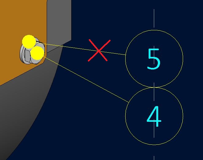

my qustion is simply. How to merge BOM balloons in drawing space? Need to "glue" the 5th position to the 4th one.
It´s useful for example for washers and screws.
See picture bellow.
Thank in any advice
July 9, 2015
Creo:
Table tab > merge balloons > follow instructions
in case above, select balloon 5 (balloon to be merged) then select balloon 4 (balloon to be merged onto)

l had to blinded when was looking into Balloon drop down menu .
Thanks for advice
