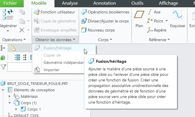

Are Merge/inheritance feature accessible with a Creo Essential license ?
I use this function in parts for years but recently we change our license "Creo Advance Design" for "Creo Essential". Since this the buttons are grayed out...
Is it a problem with my creo install or a license issue ?

Merge/Inheritance does require the advanced assembly license.  Creo Essential does not include Merge/Inheritance.

I faced the same problem. I was used to have it because I was using the machining extension. We left the machining extension for another CAM. Then we switched to essential and noticed it was not part of essential like you. We have purchased the machining extension just to have theses features. We didn't need the advanced assembly so it was cheaper to get this one.
As I said to our reseller, I don't understand why it's not included in essential. For me these are essentials to use Creo efficiently.

I have the same problem, I need basics functions of creo and the machining extension. Last year i bought a "Creo Advance" licence and this year i switch to the "Creo Essential + Machining extension" The sum of these 2 licences is cheaper than the "Creo Advance".
According to what you say Creo Machining extension include Merge/inheritance features ?
This is not the case for me ?!
Oct 3, 2024 3:23 PM UTC
Yes that's correct. The exact name of this extension is Creo Production Machining Extension.

Not a direct answer, but maybe Copy Geometry feature will be sufficient, if you don't have a licence for the feature you are asking about?
kdirth
Oct 4, 2024 2:44 PM UTC
I believe copy geometry is not included in Creo essentials (as of 7.0) and requires AAX.
