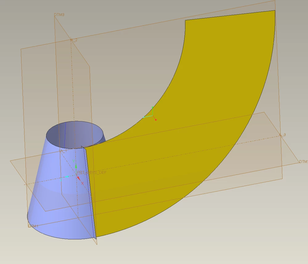

Is this what you need? The cone is split and then flattened (yellow). Creo 9 model enclosed for reference.

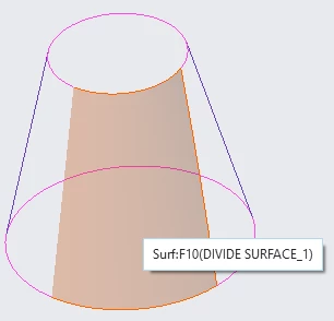

Divide surface which is available in Creo 9+ as a core modelling feature. Depending on what you are attempting to do subsequent to this it may provide a solution.
About Divide Surface (ptc.com)
Example Creo 9 part enclosed.

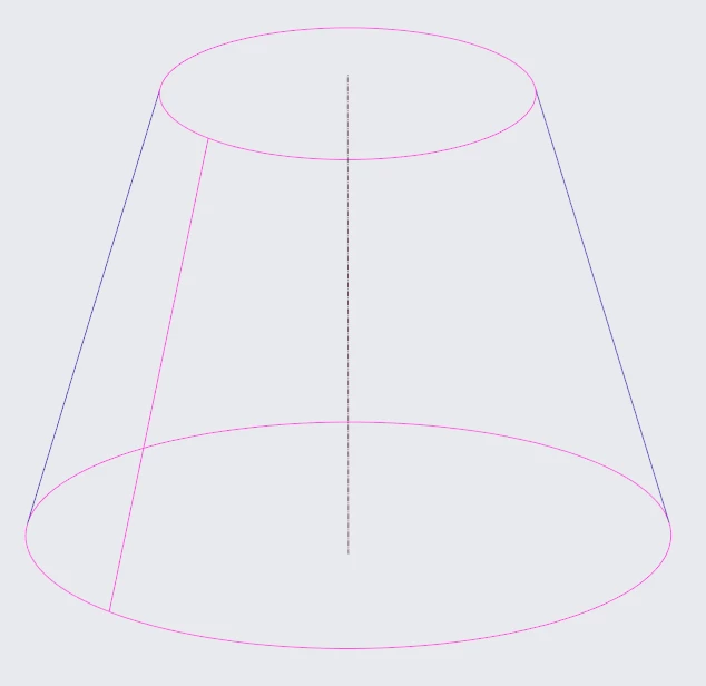

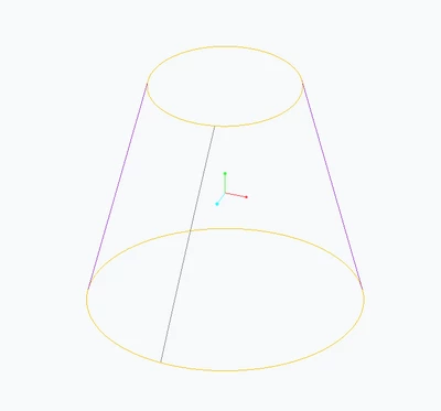

Apr 15, 2024 7:19 AM UTC
Just note ...
Resulting quilt is still divided into 2 pieces.
