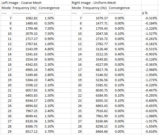

For an unconstrained modal analysis I got the following results. They have very similar mode frequencies (as expected) and the convergence seems better?

For modal analysis the mesh size is much less of an issue than for stress analysis. Basically you only need to get the stiffness and mass distribution right, so for most parts (in H-elements) any 2nd order mesh will do.
I suspect you will see larger differences in stress analysis (if you will be doing any?)
