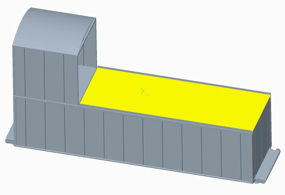

What do you intend to do with the file? Just a pretty picture or something that will be cut and mated to a structure?
September 12, 2019
Hi BenLoosli,
I have a big part part (see below) that needs to have this grating across the entire top where the yellow solid plate is shown. I can add it to this part or can create a new part and add it into an assembly. Image 1.jpg
September 12, 2019
One way to actually model this would be to use geometry pattern and even a pattern of a pattern. I'm attaching a brief presentation I did on this. It's from an old version of Pro/E so you'll have to forgive the actual GUI selections.

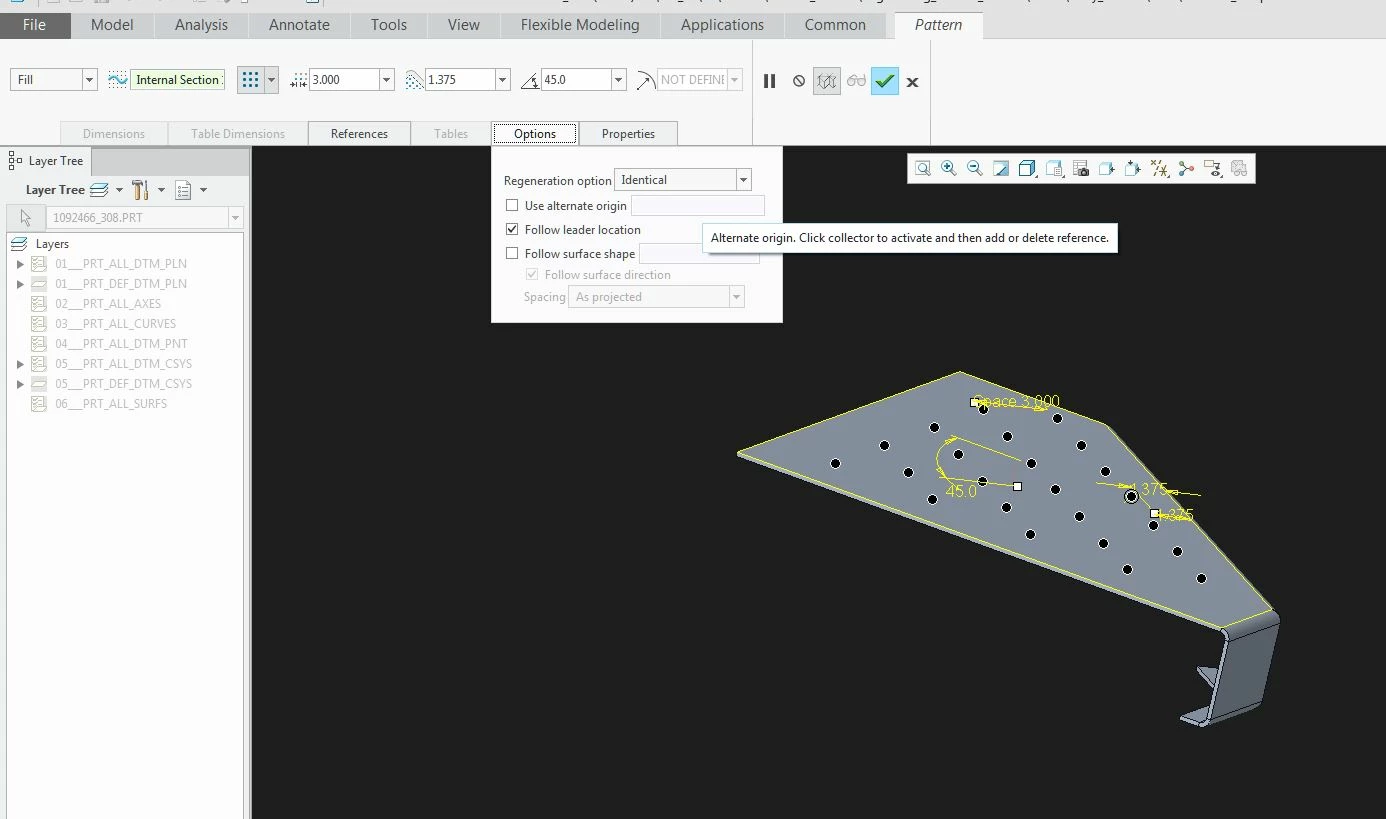

Another time saver in newer releases of Creo, (I'm using Creo 4.0 M140), is the "identical" option. This alone cut over 75% from regen time in large patterns. (See attachment)
kdirth
