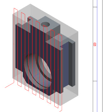

Milling Sequences - Drawing Sheet
How to convert sequences as a drawing ?
Is there any possible way to take printout each sequences as a drawing ?
If any document I need to refer means kindly mention it.
October 24, 2014

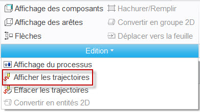

In drawing, you can display trajectory for each sequences :
David.

Hi
Thank you for your reply
My show path is invisible in my machine. I have complete machining extension license.
Kindly tell me what i need do to next ?

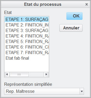

I want each and every sequence as a separate drawing .
October 28, 2014
you can select your first sheet, copy
and select an other sequence
repeat for the other step.
