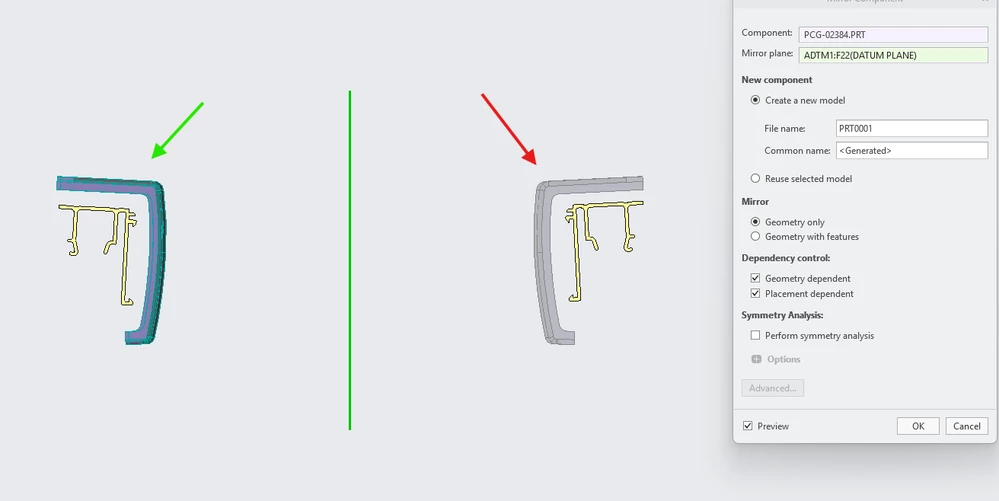

mirror part in assembly not correct
I am using Creo Parametric Release 11.0 and Datecode11.0.4.0
Can not mirror part along the plane properly in assembly if selected "Reuse existing model". Works ok if selected "Create a new model". Just toggling that option creates parts in two different locations

    Nov 17, 2025 6:29 AM UTC
    I'll try to explain this again: I need to mirror a part in assembly along a mirror plane with the same part number (create a copy or copy geometry). I can't have a different name for this part.
    When I use the "mirror component" feature I select the part (green arrow, so far so good) then I select my mirror plane (also as expected). The default option is to create a new model and when I select to preview everything is as expected - mirrored part pointed by red arrow previewed.

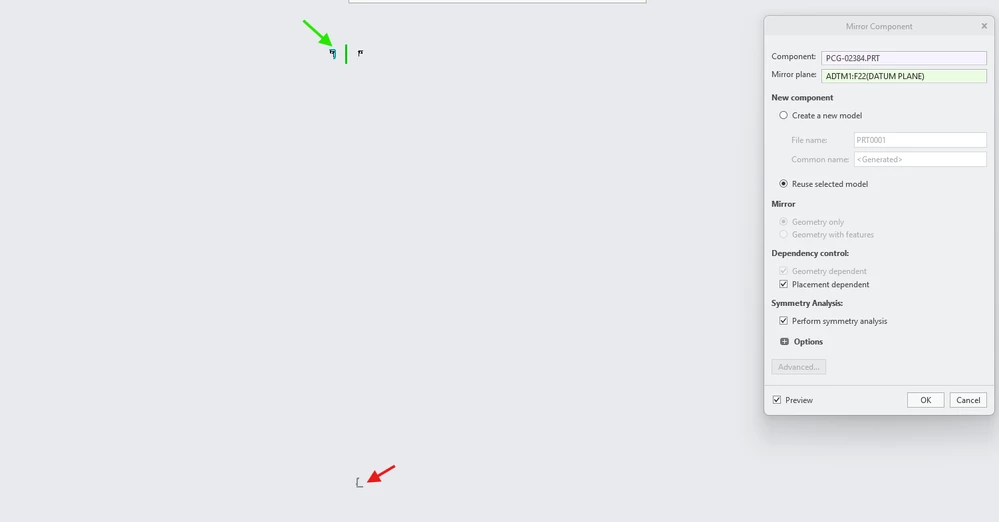

    Now, I can't enter the same name of the new model as my part, so naturally I select "reuse selected model" at which point the software flings my mirrored part somewhere far away. So the question is how am I supposed to mirror the same part about a plane?
    reuse existing modelreuse existing model

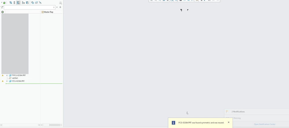

    To add to that: if I select "create a new model" and "perform symmetry analysis" the part is recognised as symmetrical and is placed with the same name but the location is completely off again.
    model reused with wrong locationmodel reused with wrong location

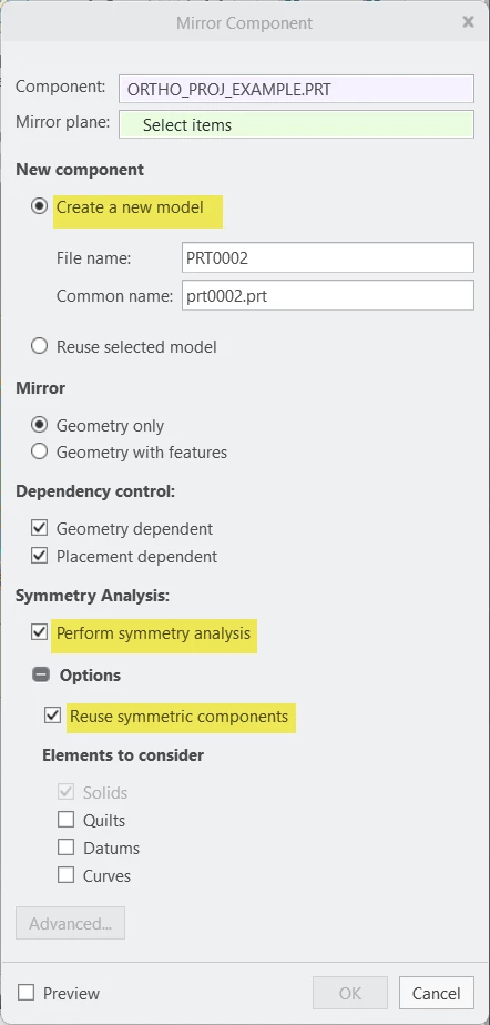

    Your latest post explains the situation in enough detail to now understand what the issue is. I suspect that the issue is that the component you are mirroring is not symmetric.
    Test this combination of Mirror Component options and report back what happens. Using these options should reuse the part if it is symmetric in this context, if not it will create a new part. By using symmetry analysis Creo should determine if the part can be reused for this operation.
