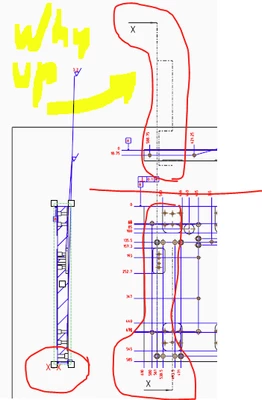

I did mirror a part and just started making a drawing of it - It has a section view. As soon as I try to show the arrows for the section view the following happens. I understand why it does what it does but I do not know how to fix it:

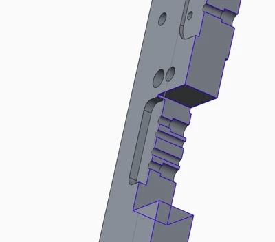

The 3D Model show the sections views correct:

Just FYI - Not a solution but maybe good information to other people that find this post:
Had talked with some other engineers in my company and they recommended me to never ever use the mirror feature in Creo - because it only creates problems... Will do. It's not a solution tho.
