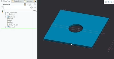

Using CREO 7 and somewhat new to using the body function.  We are trying to figure out why in skeletons you can't mirror a body with an axis that was created in the body we are trying to mirror.  So we select the body (actual body, not extrude in model tree), select axis created in body, then mirror body/axis with a datum.  The body will mirror perfectly but the axis doesn't show up.  The only way we can get the axis to mirror is to do it separately.  Any ideas on how to do this in the same mirror?

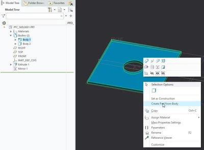

So we were under the impression that if you use bodies in a skeleton they have a lot of the same functionality as surfaces/quilts.  In some areas more functionality than using surfaces/quilts.  There is even an option to create a part from a body within the skeleton which creates a part with a copy geom of the body.

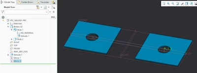

So if we created a skeleton using a body with an extruded hole and axis...

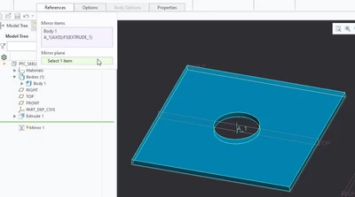

Then we mirrored said body/axis by including both in "mirror items"...

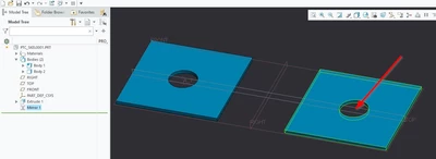

The result is the body mirrors but the axis does not.  CREO is typically pretty good about not letting you select items that won't work with different modeling functions so this was a bit odd.
But if you select just the axis and perform a mirror it will allow it.

I think that you may have found a "bug". I agree that Creo UI implies that both references should mirror as you have selected them. I have tested this in a part, and it behaves the same. I suspect it is due to the fact that the axis is not external to the body and Creo does not classify this axis as a datum entity for inclusion in a mirror.
If you query the references of the mirror in your example you should see that both the body and axis are explicit parents of the mirror feature. This is curious since the axis is not mirrored.
This command line info shown below when selecting mirror refs during the creation of the mirror feature certainly implies that you can include a body and a datum entity.
Select any number of references, such as bodies, quilts, curves or datum entities to mirror.
