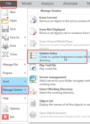

Hi Ronan,
I think you have your generic part copied to the ifx_fastener_data folder. This will not work.
Please move all your fastener to Windchill (if available) or move them to a archive folder.
Then set a Creo option search_path to this folder.
I recommend to update the index in this folder
Update IndexUpdate Index
Then the files can be found by IFX and of course by Creo if you reopen the assembly.
Oli
