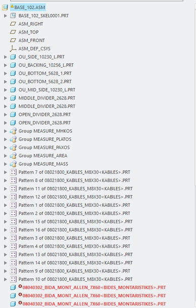

HI ,
When i open a model on CREO 6 , some componets is missing , so i must retrieve them manualy.
I have all my componets on subfolders in 3d_library folder , and search.pro file refered on those subfolders . In the model tree , componets 08021800_kabiles_m8x30 , are located in the same main folder with the missing componets. The missing componets on the second abstract , model retrieve them , if i make regen twice.
Attached abstract from  ,
config. pro ,
search.pro file on  ,D:\CREO_CAD_CAM3D
! KABILIES
"D:\CREO_CAD_CAM3D\3D_LIBRARY\KABILIES"
"D:\CREO_CAD_CAM3D\3D_LIBRARY\PODIA_KOYZINAS"
"D:\CREO_CAD_CAM3D\3D_LIBRARY\SCREWS"
and location of componets in subfolders on 3d_library folder
D:\CREO_CAD_CAM3D\3D_LIBRARY\KABILIES.  (ok, retrieve them , componets 08021800_kabiles_m8x30)
D:\CREO_CAD_CAM3D\3D_LIBRARY\SCREWS (need retrieval , missing componets)
D:\CREO_CAD_CAM3D\3D_LIBRARY\PODIA_KOYZINAS (second missing items , retrieve them after two regenarations)
Can anyone help me ? Where is my mistake ?

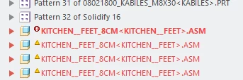

If I understand there are missing components when retrieving "BASE_102.ASM" but when you regenerate twice the missing components are retrieved.
If this is correct it sounds like Creo dies not search for the components until you regenerate a specifc model and is not an issue with search paths. Do you know why this model requires 2X regeneration to fully regenerate?
I would investigate the subassemblies of the top level assembly and determine why they are not regenerated upon retrieval from disk. Clear all models from RAM and open the subassemblies one at a time to determine why they are not regenerating and work your way up to the top level assembly.

When regen twice , Kitchen_feet componets retrieved.
Bida_mont_allen componet , does not. I must retrieve it manualy.
I have try everything.
The same goes for other models , not only with  "BASE_102.ASM" . I musτ retrieve almost everything manualy.

remove search.pro file and add following options into config.pro
search_path D:\CREO_CAD_CAM3D\3D_LIBRARY\KABILIES
search_path D:\CREO_CAD_CAM3D\3D_LIBRARY\PODIA_KOYZINAS
search_path D:\CREO_CAD_CAM3D\3D_LIBRARY\SCREWS

Maybe it was a typing mistake, but you show in your config.pro that
search_path_file D:CREO_CAD_CAM3D\START_MODEL_DIR\search.pro
But you say that the search.pro file is in D:\CREO_CAD_CAM3D
That might be part of the problem, but usually if parts are "findable" by Creo it will load them. The only time I've had to regenerate is when they were in a directory not listed in the search.pro.

How @MartinHanak said, remove the search.pro file and add the search path to your config.pro. You can add multiple paths on the same line.
remove search.pro file and add edit the search path into config.pro
search_path
D:\CREO_CAD_CAM3D\3D_LIBRARY\KABILIES, D:\CREO_CAD_CAM3D\3D_LIBRARY\PODIA_KOYZINAS, D:\CREO_CAD_CAM3D\3D_LIBRARY\SCREWS
Second thought...
Double-check if you call the search_path_file it is set for the correct location.
From your pictures, you have a different path in Creo config.pro than the actual location of the file
Creo config calls: D:\CREO_CAD_CA,3D\START_MODEL_DIR\search.pro
And the actual location of the search.pro file is: D:\CREO_CAD_CAM3D

Giben1-VisitorAuthor
Feb 8, 2021 8:01 PM UTC
Thanks all for your help.
At first , i had typing wrong the path of config.pro , as the correct location is  D:\CREO_CAD_CAM3D\START_MODEL_DIR\search.pro .
 I have try anything. My last change is the suggest of @MartinHanak to edit the config.pro with search_path option , in a row with commas separators.
I dont know what else can i do
