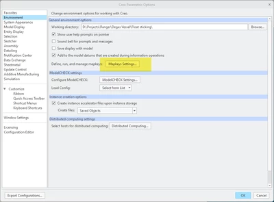

I have creo 7 installed in my system. In it i am missing a set of icons in the quick access toolbar which is regularly needed for me. All my colleagues have those. i tried copying there confi.pro and other folders but nothing seemed to work. These are the icons that i need. Can anyone help?

I am guessing that some of those in the list on the right-hand side are mapkeys that are mapped to icons for use in the UI. This explains why you are not able to find them in the GUI.
Are any of those commands found in the list of mapkeys in a Creo session that has the desired UI? You can find the mapkeys using:
 File > Options > Environment > Mapkeys Settings
