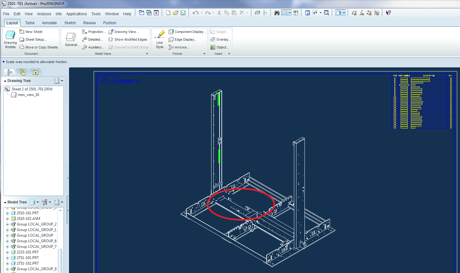

Below is a drawing on "Follow Environment" display style:

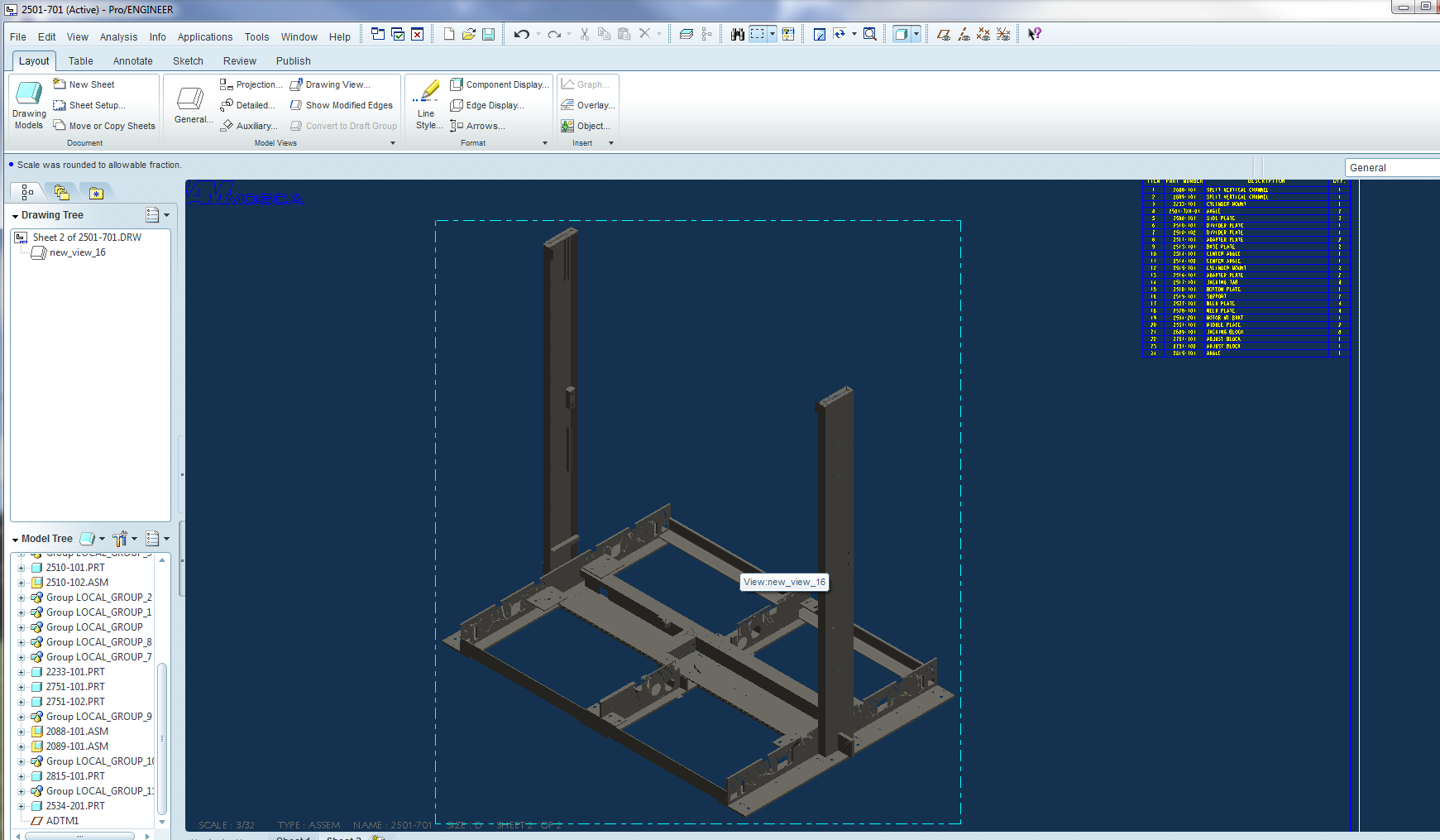

If display style changed to "No Hidden", some lines were disappeared as below"
This issue happened before.
Appreciate if you can help me to fix this problem

check your assembly for global inteferences. This can be source of your problem.

Martin,
You are right.
After I check "Global Inteferences", the lines appear.

It's like the issue was fixed yesterday after I check Global Intefereances. But it still there again when I open the drawing today, and I did try to check Global Inteferances, no lucky to fix this issue.
I don't know why ?

if interferences are detected in the assembly then 3D view can be displayed incorrectly. You have to remove interferences, if you want to display correct 3D view on the drawing.
Note: The root of your problem can be something else. Without your data, it is difficult to give you the right answer.
