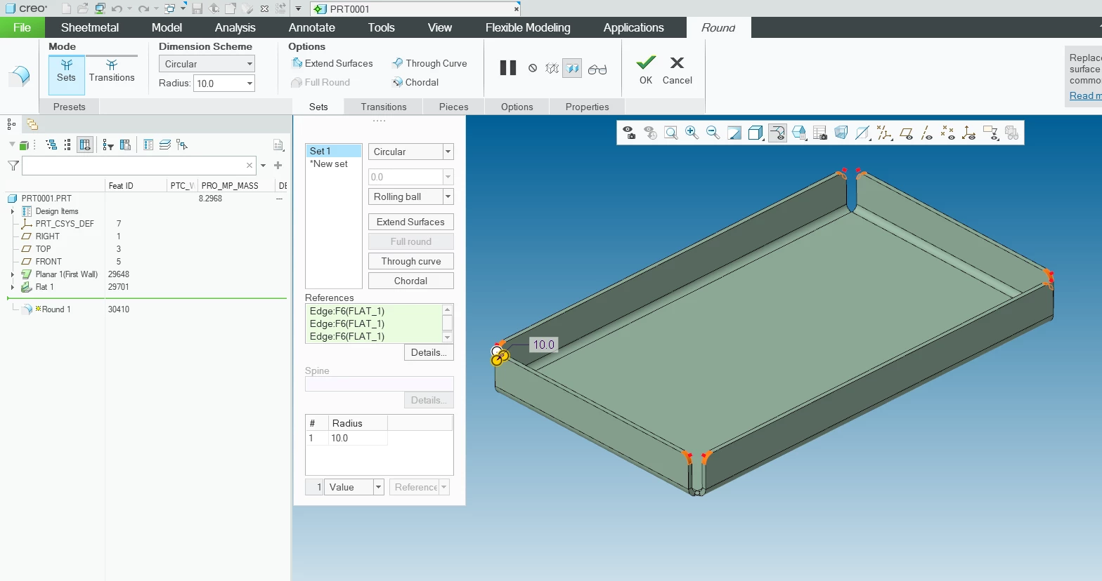

An enhancement, heres an example - I could design a sheetmetal part  with some flanges, I might originally decide to have no corner treatment and add rounds to the edges of my flanges. Later I might decide, you know what, I want corner treatment with a seam, now all some of the edges the rounds were referencing are not present.
I have to click edit definition of the round and one by one remove the missing references so the round feature no longer fails - in SolidWorks when editing a feature that has failed because of missing references you can edit the fillet as its called in SolidWorks in my example and remove all the individual rounds that have missing references in one go instead of removing the missing rounds one by one until the feature has no longer failed

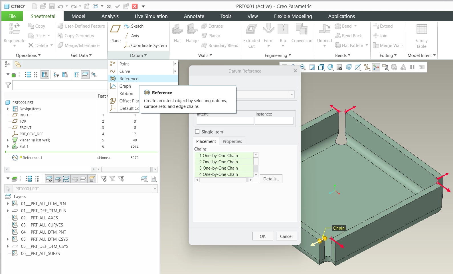

First - how do i select those edges using intent chain?
tbraxton
Sep 10, 2026 11:24 PM UTC
Use a datum reference feature to define the domain of the intent reference needed to create the round. See the enclosed video for details.
Datum reference chain creation

​@Michael_Bourque does raise a valid point in this context with the suggestion to use intent references during feature creation (or re-route). In the situations where intent refs are not available for selection you should be able to create a datum reference feature to realize the same benefits of using an intent reference. With datum reference features you are able to define the domain of intent references for use in feature creation. This enables the user to capture design intent through the creation of intent objects.
Refer to this chart for more details: About Intent Objects

It would seem that you are actually asking does Creo work the same as SW and the answer is no.
Creo does not automatically remove rounds etc. when a reference fails and the user does not have to delete them either. You have the option to suspend features with missing references and rerouting or deleting missing references and resuming all affected features once the references deficiencies are resolved.

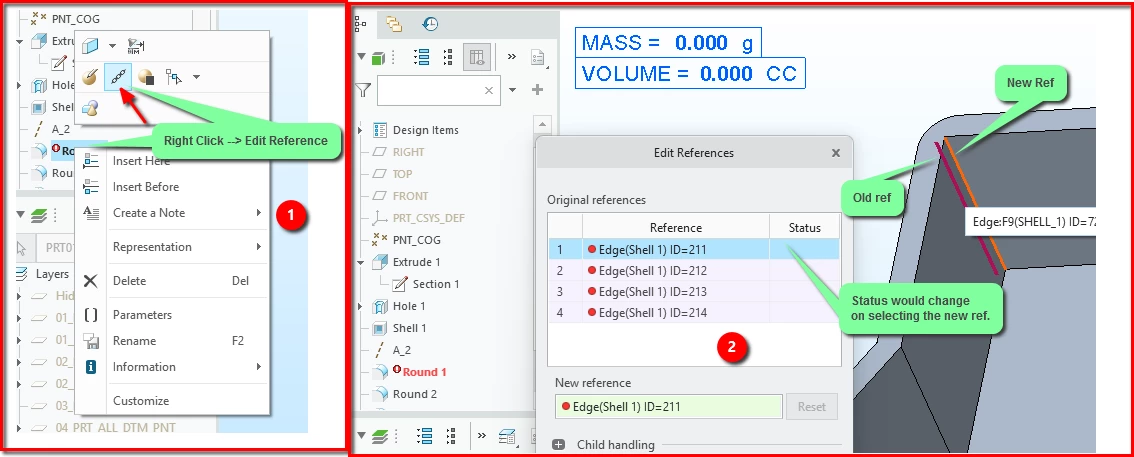

Sep 17, 2026 11:00 AM UTC
No. There is no single button by which you can remove the failed edges. However, Creo gives you a way to remove / replace the failed edges with a changed edge and add new edges if necessary.

I also know that Edit References like you suggested allows you to quickly redirect a missing reference to a new one, and that's useful when you actually want to replace the reference. But that isn't always the required solution. Sometimes I simply don't want those failed rounds anymore — I just want the missing references removed while keeping all the remaining valid rounds in the feature.
For parts containing a large number of rounds, this would turn an unnecessarily repetitive manual process into a one-click operation.
