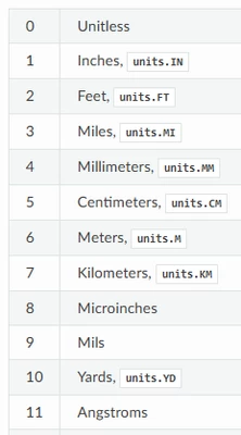

Open the DXF file in a text editor and search for INSUNITS.  Should see something like below.
If the value highlighted is a 4, the length unit is MM.
Here are some other values for different units of length.
If the DXF is in millimeters, then the software that is importing the DXF is doing the conversion.

Same issue here, using CREO 13 Flat pattern export. Everything is in mm, but the resulting DXF is not.
$INSUNITS
 70
1
  0
