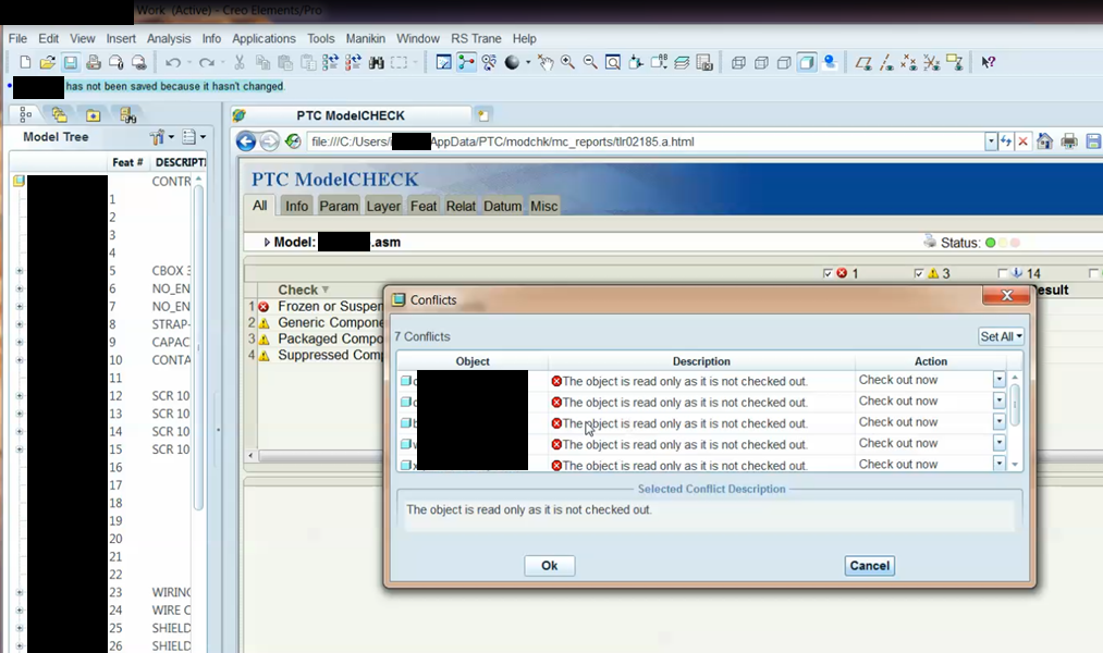

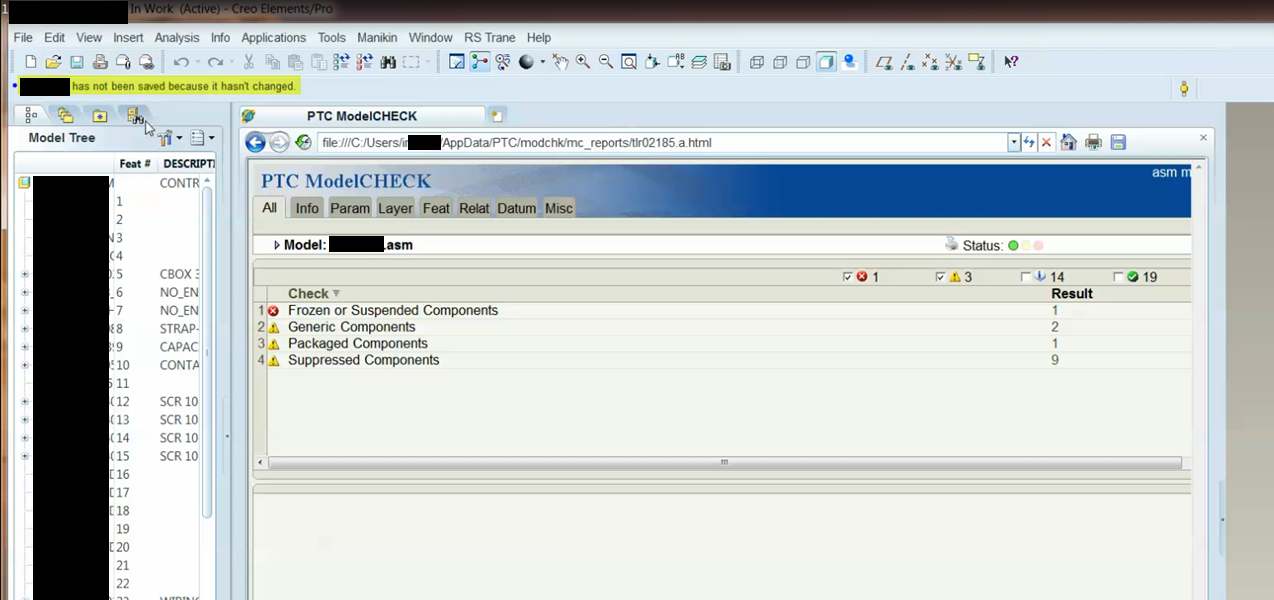

1. Add to Local Workspace an assembly and open in Creo Elements/Pro>Save - message states "not saved as model not changed, expected results
2. Do another Save - Conflict window appears asking for you to set check out, read only or continue on all the components (nothing was modified).
I have looked at and tested several configurations that affect save operations to no avail. When I disable MC I do not get behavior. Anyone with MC running have this issue?

In my config_init.mcc file I had removed the below section
# Duplicate models - Automatically add dup model info to text file
# Y - always add model info
# N - Never add model info
# D - add model info but Don't overwrite existing info
# A - always Ask the user whether to add AND whether to overwrite
ADD_DUP_INFO_AUTO YNDA N N N N
Evidentally this is needed in order to use the DUPLICATE_MODELS in the defaults_check.mch file (set to "N").
This setting or lack of in the config_init.mcc was requiring the dependant compenents to be modified.
