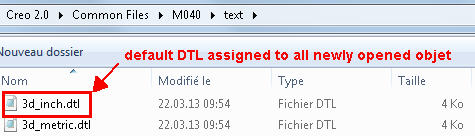

model_detail_option_file Creo 2.0 option should assign a chosen 3D.dtl to all newly opened objet
The model_detail_option_file option should assign a chosen 3D.dtl when opening an object created before Creo 2.0.
Actually, Creo 2.0 assigns the default 3D_inch.dtl to all newly opened objet. We need 3D_metric.dtl.
The model_detail_option_file option is only valid for empty objects.

Antonius,
- Our 3D templates have 3D_metric.dtl assigned = OK
- Creating an empty component, and the model_detail_option_file  option (path to 3D_metric.dtl) will assign the defined 3D_metric.dtl to the object = OK
The problem that we can have here in Europe is in simply opening old Wildfire objects for example, and it is the 3D_inch.dtl (in text folder) that is assigned by default and not the 3D_metric.dtl nor the model_detail_option_file option path to the 3D_metric.dtl.
Risk here is to “pollute” European objects with 3D_inch.dtl
Workaround is to name 3D_metric.dtl  in 3D_inch.dtl …
Hope you understand the explanation.
Nicolas
