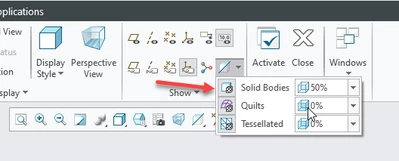

The parts in question, are they solid bodies or quilts?  Do you have transparency turned all the way up?
If you have solid bodies that are transparent and you don't want that, you can either toggle the button next to solid bodies to disable transparency mode across the board or you can click on the body in the design tree and disable transparency for each solid body.

Thank you for your response.
The parts are solid bodies and I do not have the transparency turned on for these parts.
