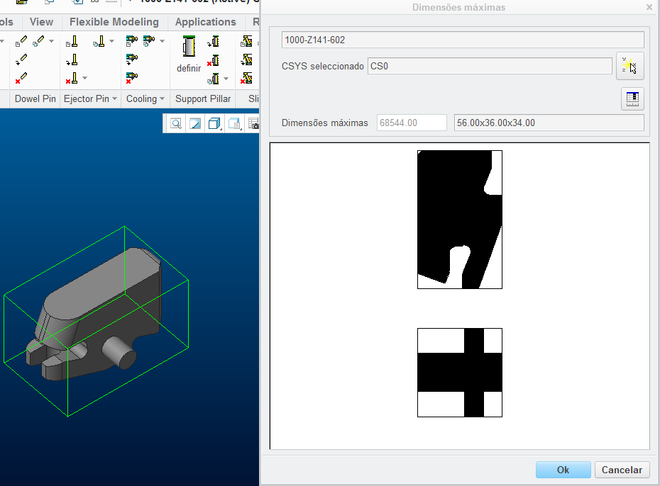

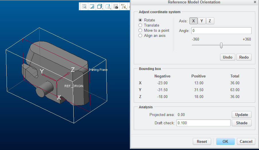

Solution 4 - Manufacturing module (MDO)
Mfg module can measure a boundary box, but you have to do one by one and copy values, no parameter is created.

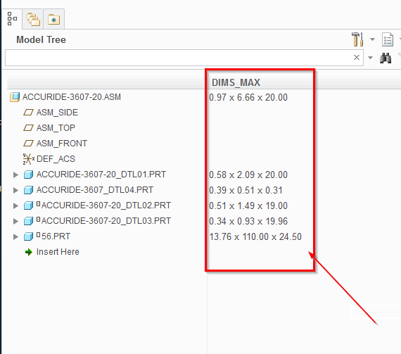

I tried Modelcheck and it works. I'm no expert in this but here is what I did:
Check your config.pro to see where are your modelcheck configs, example:
modelcheck_dir c:\Creo_Configs\MODEL_CHECK_CONFIGURATION
If you don't have copy this folder and use it:
....\Creo 3.0\M000\Common Files\modchk\text\usascii
Then edit the following file:
c:\Creo_Configs\MODEL_CHECK_CONFIGURATION\config\start\default_start.mcs
and add the following line at the bottom:
PRT_ADD_CHK_PARAM DIMS_MAX OVERALL_SIZE
This will create a parameter called "DIMS_MAX" (or choose another name) with the overall size in each part.
Restart Creo, open a assembly
Menu File->Prepare->Modelcheck Interactive->All Levels->Regenerate
Hope it helps.

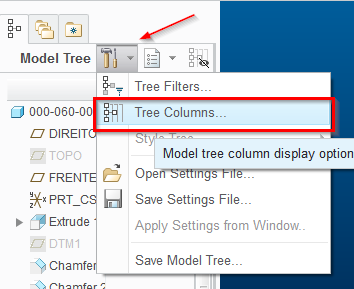

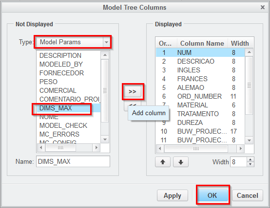

That`s quite fascinating. However, I`ve done all the sequence of operations that you mentioned and encountered the problem of not being able to have the parameter `DIMS_MAX` shown in the model tree. How to do that?
February 3, 2017
Just add it to the tree.
If it doesn't appear in assembly mode, do it in part mode, do "save settings file..." and do "Open settings file.." in asm mode.
EDIT: I found out that you need to change the file condition.mcc. I attached both, replace them and test.
