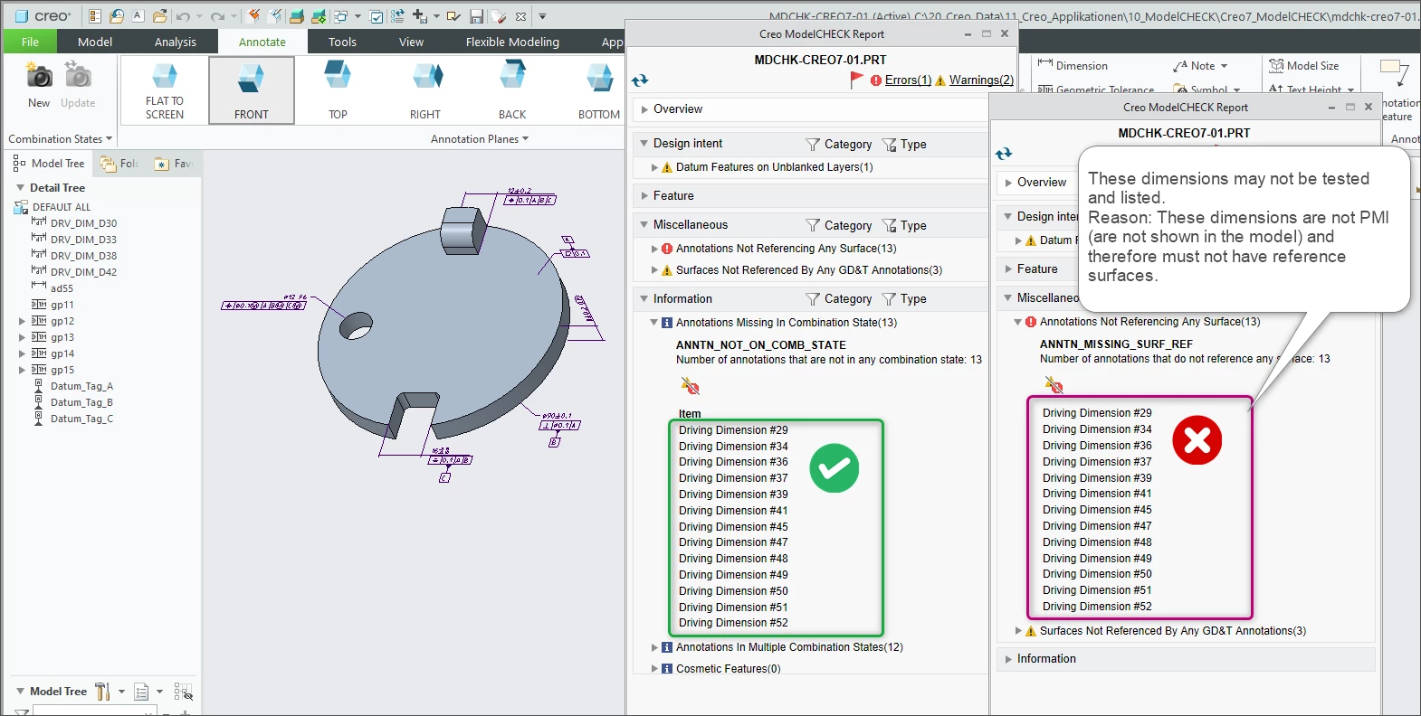

ModelCHECK check of annotations with missing reference surfaces
I am using Creo Parametric - Release 7.0 (connected) 7.0 7.0.4.0
Regarding Creo ModelCHECK check with options:
- config_init: MC_MBD_IGNORE_DRIVING_DIMS N
- checks: ANNTN_MISSING_SURF_REF E
Result: All driven dimensions with missing reference surfaces are listed, even dimensions that are not shown in the model and are not PMI.
Problem: Dimensions that are needed for modeling the model but are not shown must not be listed. It is impossible and pointless to assign reference surfaces to all dimensions existing in the model.
Question: Can ModelCHECK be configured to list only driven dimensions that are shown in the model?
Remark: Which annotations are not shown is known by the following option: ANNTN_NOT_ON_COMB_STATE Y
Picture and test model are attached to the case.
