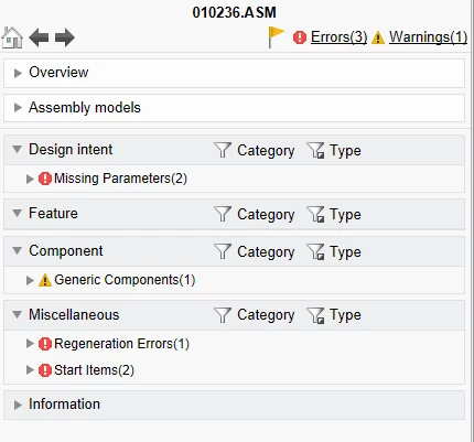

I've been using Modelcheck in Creo 5 for a few months now, as I configure our setup from Creo 4 and prepare for training and migration. I would like to provide feedback:

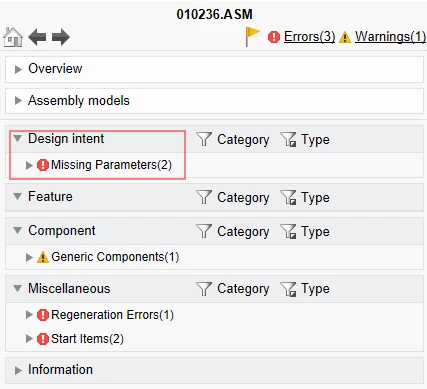

  1. The number on top, next to the Errors and Warnings, would seem to be a cumulative value of all of the numbers of errors and warnings within the subsections, due to the same way they are identified. For instance, in the below picture, if a user was expanding a random section, he would assume there is nothing in Design Intent and Feature as there are already three errors listed and 1 warning:

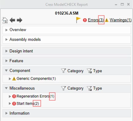

    Rather, if we expand all sections, we see more errors:
    Although I understand that the number on top is the check# and the number next to the checks are the quantity #, it is confusing since they are identified the same way
  2. I'm not sure users care whether errors or warnings are identified as Design Intent, Feature, Component or Misc. Whatever the organization has identified as important will be an error and whatever they identified as not critical, will be a warning. I'm not sure how these categories help.

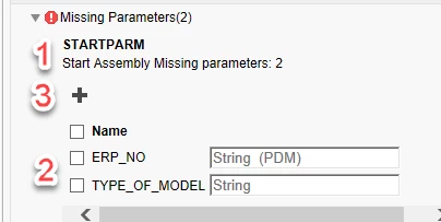

  3. When trying to fix an issue, it appears that the flow is also confusing. In a given check, the description is at the top(step 1),  the field to specify the fix is at the button (step 2), and the button to fix it is in the middle (step 3). It would be equivalent to an online form where the submit button is at the top of the page instead of after the entry fields. Also, I'm not sure if the icons are 100% obvious to the action of the buttons.8c38494e-0bcf-4f63-ba0a-7f43ea009e82.png
    This was probably done for a user who may not realize there is a way to fix an issue if the button is not visible from the beginning. I think a different way of showing the data will help with this.
  4. In Creo 4, the default results for a Modelcheck regenerate showed the ALL tab which listed all errors and warnings. Here, not all categories are expanded from the beginning. This introduces a high risk of users missing the checks when they are trying to rush and get out a part by adding extra work for an improved tool. Users aren't a big fan of a tool which finds their mistakes to begin with. Having extra work to hunt for them is not going to go over well. Furthermore, now they can say they didn't see the checks when the report came up since it was buried. I can't even use a mapkey to show all checks since the commands are not mapkey sensitive. It goes without saying that the Overview and Information section should NOT be expanded by default. At this time, I am not sure if there is enough benefit to migrate to Creo 5 if this last issue does not get addressed before then.

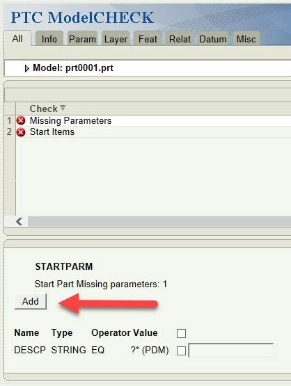

I probably agree with the icons as well. The old "Add" and "Update" buttons were more obvious that ModelCheck could help users add missing info than + sign and a pencil. Not near as much of a problem as the categories though.

3. I agree with you on this one as well. However, the reason that the buttons are above the list of features/parameters/layers/etc. is for situations in which that list is long, in which a user might not realize that there is an action that can be taken. From your perspectives, would having the buttons at the bottom of the list be an acceptable change?
4. A few thoughts on this one: (a) You may already know this, but clicking the top Errors or Warnings link will expand all of the groups in which Errors or Warnings are found. (b) Currently, only Design Intent gets expanded by default. I don't really like this. I'd rather have all groups with errors/warnings expanded by default. The only potential problem here is that in cases in which there are many errors/warnings, seeing all of them would require users to scroll. Personally, I think that's fine, but I'd love to validate that. Thoughts? (c) There's a hidden config that you can use to show all of the errors/warnings in an "All" category. They are still listed in their respective groups, which means that technically they are listed twice in the report. But you may still find it useful. (MC_REPORT_SHOW_ALL_TAB    YN)

3. I understand. My concern is that it isn't even noticeable that some of these are buttons. I would update the GUI to make it obvious it is a button and replace the icon with the actual task name, or include the icon with the name, like every other button in Creo (by default). If you really want to revamp the GUI :(, after a check is expanded, the information should be split vertically. The issues on the left with a nice obvious big task button to the right. As you scroll through the list, the task buttons do not scroll as well.
4. Hidden config - AWESOME! It is now part of the company standard. Now we can push out Creo 5 when ready :). In order for a user to scroll, they would have to have upwards of 20 errors and warnings, which (I should imagine) is highly unlikely. Rather, a typical user would see a handful of issues and would like to see them at once. Getting users to run modelcheck was a long and tedious journey that we are still very much a part of. Having users press extra buttons to see mistakes they made is not something anyone would want to do. As it is, we have an advanced mapkey that does so much more than modelcheck, which they use; just so that our users save as much time as they can. Otherwise they won't use it.
