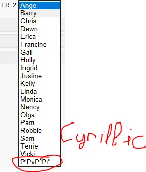

Hello everyone!
ModelCHECK does not accept model parameters in Cyrillic.
How can I fix this problem?
Regards!
Best answer by VladiSlav
Hello!
I found a solution:
It is necessary to select the parameter MC_SUPPORT_LEGACY_STRING in the config_init.mc file (select "N").
Then reload Creo Parametric.
Then everything worked in my case.
Best Regards!

VladiSlav17-PeridotAuthorAnswer
November 16, 2019
Hello!
I found a solution:
Best Regards!
