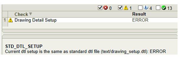

I had heard before that when you see this result in ModelCHECK its because you have to many for it to count. Has anyone seen documentation on this issue?
July 20, 2016
July 20, 2016
Bharath I have the description, but I need to understand why the result says error. Us ally it give you a number, 1, 2, 3 etc
September 14, 2016
Hi, Found any solution for this?
September 29, 2016
Yes I have, we had an old Unix path pointing to one of our files.
Old
STD_DRW_DTL_FILE                    text/drawing_setup.dtl
New
STD_DRW_DTL_FILE                    text\drawing_setup.dtl
