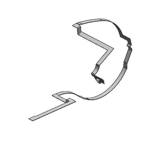

So what is the PTC way to model a FPC in 3D and then create a flat pattern ? The sheet metal application?

Hi Richard,
I do not think that there is the one "PTC" approach for this but various possibilities...
- sheetmetal as you say
- Warp
- spinal bend
- offset coord sys
... all this combined with flexibility...
It now really depends on what exactly you want to do

Here's one of our more complex ones. The width is about a centimeter.

Hi Richard...
I believe Flex Circuits is one of the things we're working on for Creo Cabling for Creo 3.0!
Right now you can certainly use the sheetmetal method. You might also get some limited use from ribbon cables in Creo Cabling (although the hard 90 degree bends will be problematic). Constantin is correct to say right now you've got several options. None of them are the PTC "best practice" for creating a flex circuit.
You'll likely have to use a variety of techniques until we have a dedicated tool. The ones Constantin noted in his message are all good candidates. If I were doing this, I'd probably try to stick with sheet metal using sweeps for some of the larger bends and loops. Sheet metal can be finicky on the unbending, though. This is another area where Creo 2/3 will shine... better unbending tools in sheetmetal.
If you have any specific questions on any of the techniques Constantin suggested... or if you just get stuck with a sheet metal issue, write back and let us know. I'm sure we can help you through it.
