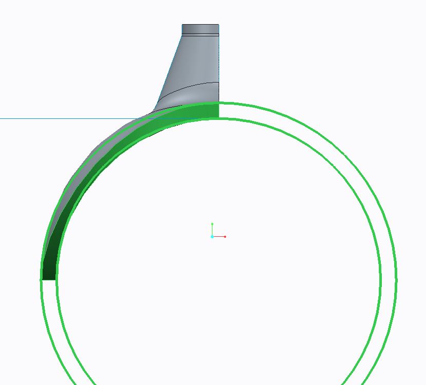

Hello, I have made progress but have encountered some issues (which I think are related to the 'blended sweep' function in Creo 2.0).
I have several screenshots here: Pressure_Vessel_Nozzle by rhamill95 | Photobucket   [Photobucket link]. The picture titles give some detail as to what they are.

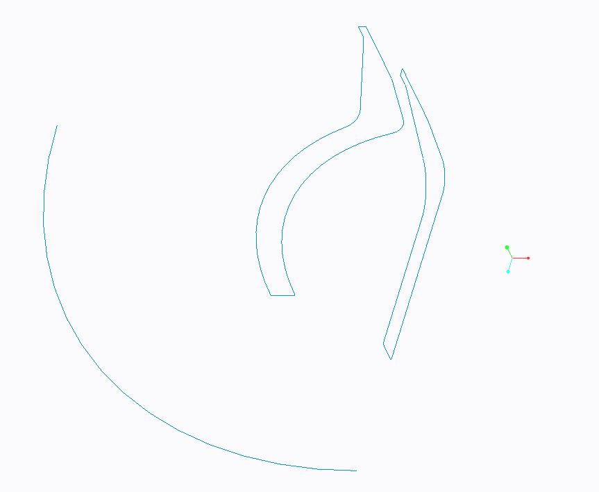

So far I have successfully created what I am fairly confident are the correct section geometries (was given details of these). I then inserted both sketches into one part file and created a 90 deg sketch (quarter circle) to be swept around. I have then used a 'swept blend' of surface one (with the curved wall) to the other around the line. I have also tried using the rotational blend feature which as expected gives the same result.
The problem I am having is that wall thickness is not uniform when it is swept. Therefore the pressure vessel would not have a constant wall thickness (as shown below) and I cannot extrude the main cylindrical body through. How can I get fix this issue and produce the geometry as shown in the original question? I have tried playing with the 'tangency' options as shown in the pictures in the link. Thanks for your help and I would really appreciate any replies!

Your first picture looks like a half cylinder with a nozzle bonded into it.
The second post shows two sections both of which show the nozzle 'thickness' to be quite different than the main 'pressure vessel' geometry.
For constant thickness walls, I would recommend you use the offset or the shell tools. Perhaps break up the problem into modeling the overall vessel and the nozzle somewhat separately.

The nozzle is incorporated into the cylinder. (I.e. the nozzle wall is thicker in parts however it then runs down into the cylinder so that it merges into the cylinder). The picture included at the end of my second post shows that it is almost right but if zoomed in on, the cylinder wall does not match the nozzle wall as it should. I hope that makes sense as it is difficult to explain!

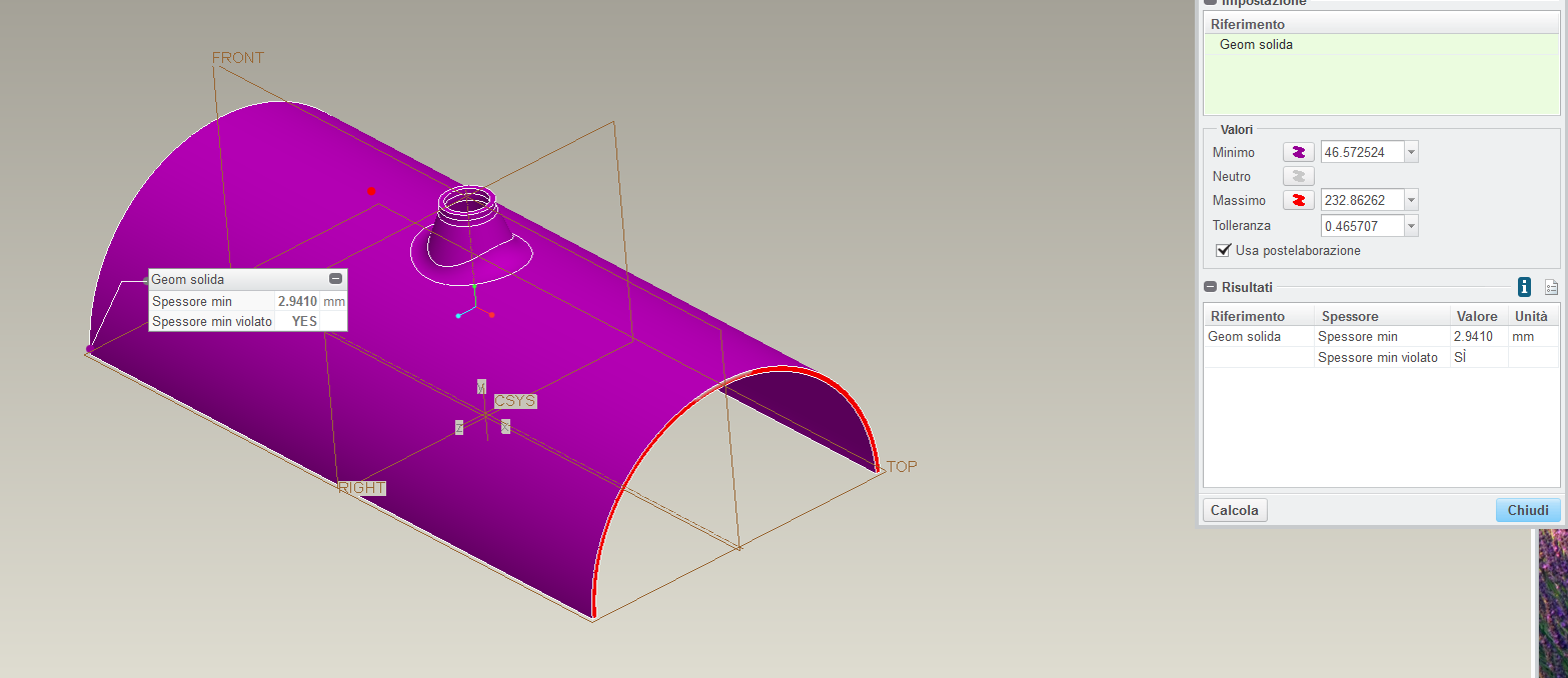

It's not my field of modeling. Anyway i made a quilt and then thickened (3mm). After this only one point wasn't 3 mm (thickness analysis). Someone expert of this can give a check.

Thanks for your response! I had considered that initially however the model is not actually of uniform thickness (the nozzel thickness varies)! I am not sure if I have permission to upload my model but will find out and see. I am aiming for something like Antonius Dirriwachter has posted, so am hoping he can try to explain how he managed to achieve it and hopefully others can learn from this! Thanks, Robert
