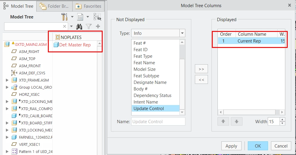

Hi all,
Creo 4, M050

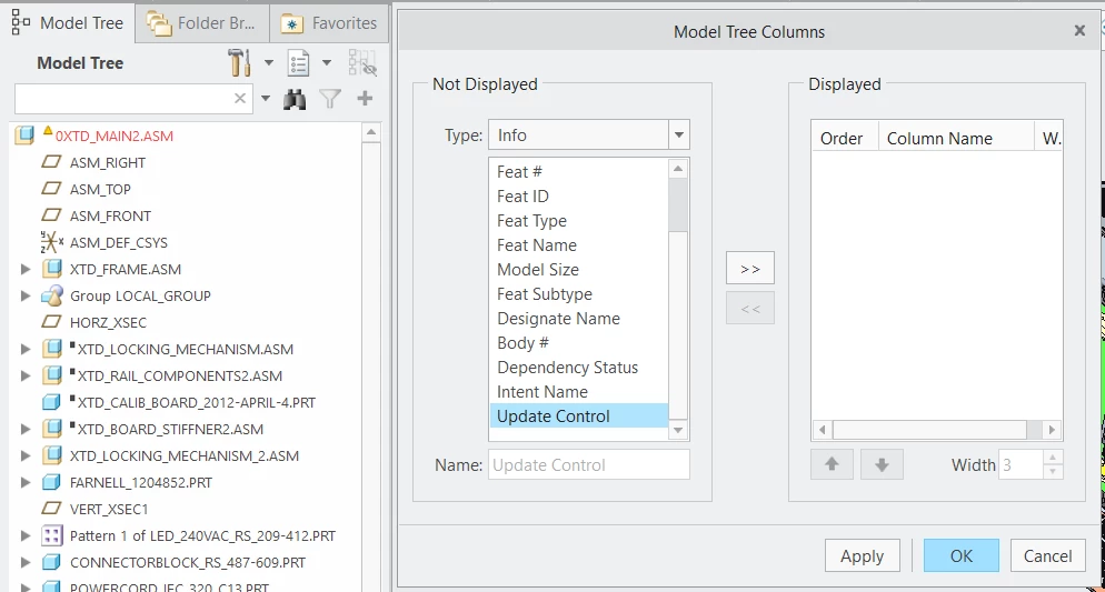

In my ModelTree configuration, I don't have any extra columns selected to be shown in the ModelTree.
If I open an assembly and select a Simplified Representation to be applied to my assembly, there is automatically an extra column created in my ModelTree that shows the Simpl Reps of all assembly components (if any).
If I then open a subassembly, the ModelTree also has this extra column.
I find this annoying and would like to turn this 'feature' off if possible.
Is there an option that I can set so that no extra columns are created in the ModelTree?
There is not a tree.cfg file on my entire desktop that has specified to add an extra column.
Screenshots show ModelTree and its column settings after and before I open a Simpl Rep in the assembly.
Best answer by LukaszMazur
in your config.pro file (or Configuration Editor in Creo Options) add an option simprep_column_display and set its value to manual. That way the column won't be added automatically and you'd need to configure it manually through Tree Columns.

Brilliant! That does exactly what I want!
I hadn't found that option yet.
Thank you so much!
