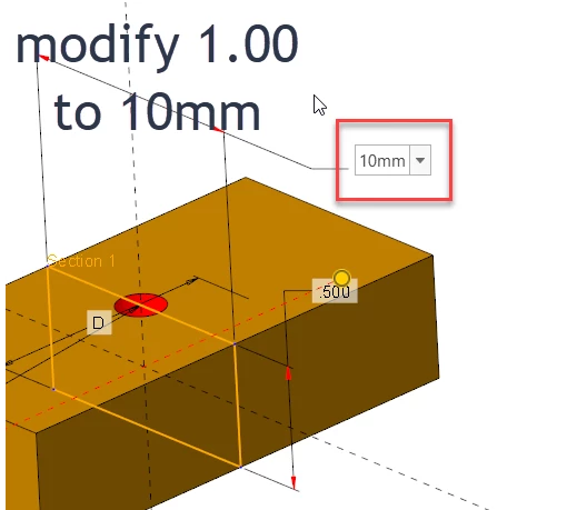

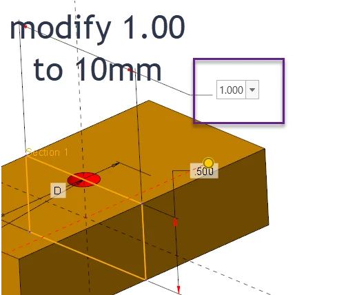

To all,
I had a question and I thought I could just modify a dimension in a part by adding on "mm" to the value. So in other words not change from inch to mm in my model, just modify an inch value directly to mm without using a conversion factor. I thought this was something that PTC had available to do in an earlier version, as we are now using Creo8. In the images attached I tried to just include mm in my change, but it did not work.
Dennis
I have never heard of the functionality you describe.
Simply enter 10/25.4 to set 10mm in "inch-model".
I don't think PTC CAD (Pro/e, Wildfire, Creo) have ever had that option.
Unigraphics or NX I know used to have it, but I haven't used NX since NX6, 13 years ago.
You would enter the value you wanted with mm(10) in an english part would give you ~3/8 in dimension. Entering in(.375) in a metric part would give you 9.xxxx metric dimension.
