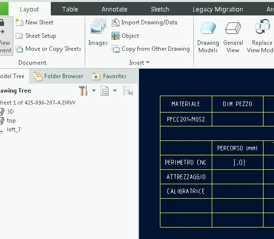

Good morning everyone,
CREO8 M30 drawing:
why can't move a table if I have the "LAYOUT" or "SKETCH" menu item active?
while with all the others I move it.
Thanks for your time, Luca.

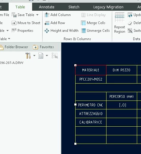

Dec 28, 2022 8:30 PM UTC
By default, if you are in Layout or in Sketch tab, tables are not selectable.
It’s not necessary to look in what tab you are . Just move the mouse over the table. If the table do not pre-highlight, press (and hold) the Alt key. Now, with the Alt key pressed, the table can be selected (and then moved).
Maybe you have disabled preselection highlighting?

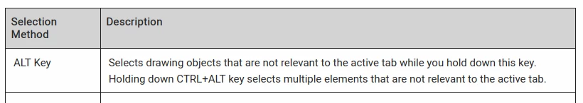

Hello Luca,
for selecting objects that are not relevant to the active tab press and hold the ALT key.
See help page:
https://support.ptc.com/help/creo/creo_pma/r9.0/usascii/index.html#page/detail/Selecting_Objects_in_Drawings.html#

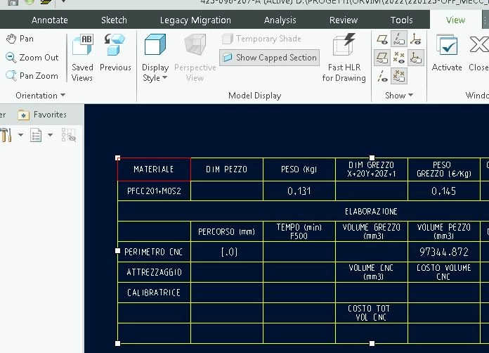

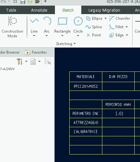

Dec 28, 2022 1:02 PM UTC
I'trying, CREO8 M030,:
the problem has reversed:
now eith the Alt key and active "layout" or "Sketch"  I move the table,
if other menu are active the Alt key does not work:
ultimately if I want to move the table I always have to check wich menu is active!!
a time waster.
