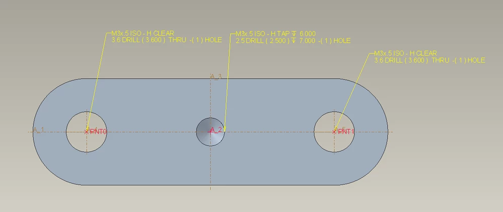

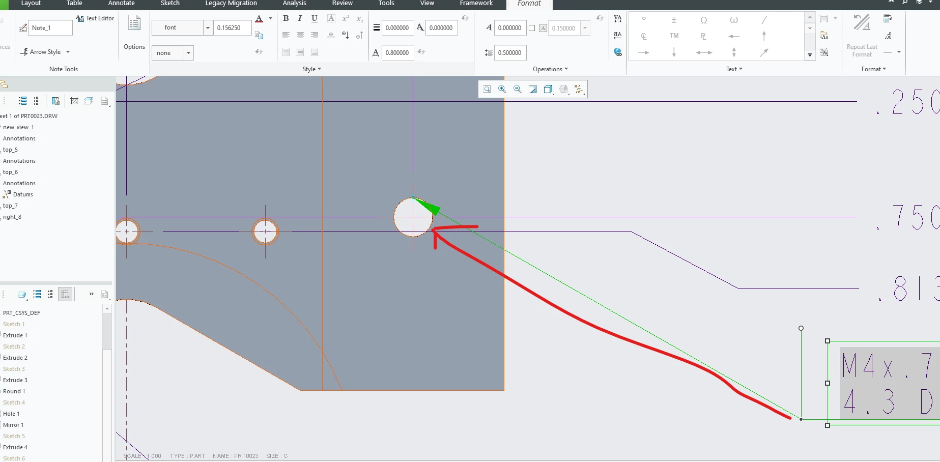

Moving Callout Arrowhead to Hole Center
I hope you're all doing well. I've recently encountered a challenge while working on my CAD drawings, and I'm in need of some guidance. Specifically, I'm looking for a way to move the callout arrowhead to the center of a hole in my drawings, rather than having it point to the edge of the circle. I believe this adjustment would enhance the precision and clarity of my designs.

One way to realize this with a standard hole feature is to locate the hole using a datum point at the center of the hole when creating it. You may have to add a point above the hole in the model tree to reference it if one is not already available. You will see in the picture the difference in how the leader is placed when using an axis vs a point when creating the holes.
