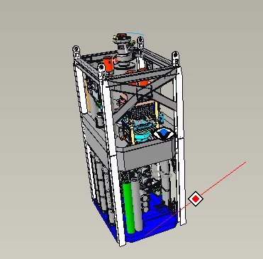

I'm on Creo 4. It looks as if mine stays at the center.
Is it after you do something specific you notice it goes off?
I grabbed a screenshot while rotating and it seems to stay centered no matter what I do.
